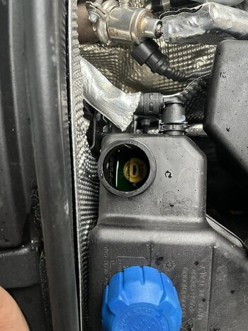

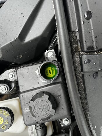

Thank you for your suggestion. Here is the current situation with the reservoirs. The one with the black cap is overfilled; the level is above the maximum mark. The reservoir with the blue cap has its level between the minimum and maximum marks. Should I therefore drain a bit from the black-cap reservoir and top up the blue-cap one?
In addition to the system not cooling properly, when it does provide a small amount of cooling through the front air vents, the rear seat air vents blow very hot air. In other words, the system is not only chaotic in terms of the air temperature it delivers, but each vent is supplying air at a different temperature. The rear seat vents always blow extremely hot air.
I suspect there must be an issue with the valves that distribute air to the different outlets, since being a “single-zone” system all vents should deliver air at the same temperature.

The black coolant. I would take some out. Don’t overfill otherwise it will leak out of the seams or lid when pressurised (as per your picture).
Fill the blue one to max. (Controls the air con)
Rear vent hotter then front is unfortunately normal. Many people have the same issue. Ineos probably designed it this way because the Ineos doesn’t have any rear floor vents. There is nothing wrong with the actuators. It’s software.
Try this first before going to the dealer to regas the air con and check for leaks.
