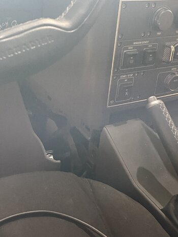

putting this here just because it’s the newest heating thread.

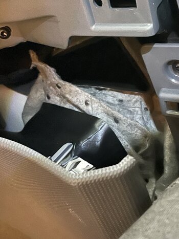

IMG_8011.jpegPop the lower panel off the center console and check the foot air duct. Mine had either a rag or insulation wedged between the connecting sections of duct work preventing air from reaching the footwells on the left side. (LHD)
View attachment 7909800Pop the lower panel off the center console and check the foot air duct. Mine had either a rag or insulation wedged between the connecting sections of duct work preventing air from reaching the footwells on the left side. (LHD)
I think someone has stuck that there to mop up the condensation drips.
I’m almost certain the condensation drips against the side of the centre console is software. I’ve taken some of the lower dashboard out, lagged it and it didn’t make much difference. I’ve lagged the pipes more than once and it comes back depending on climate. One of the pipes right behind the glove box is roasting hot.
I noticed after putting my finger up there after dripping, water is actually coming out of the lower vents ducting on the passenger side and the only time it leaks is when you get hot air blowing in the rear and cold air blowing on the windscreen in Auto. Which makes sense as hot and cold air blowing will condensate. It happens particularly if the sun has been out and the interior is hot. There is no rusting to the metal chassis at the back.
