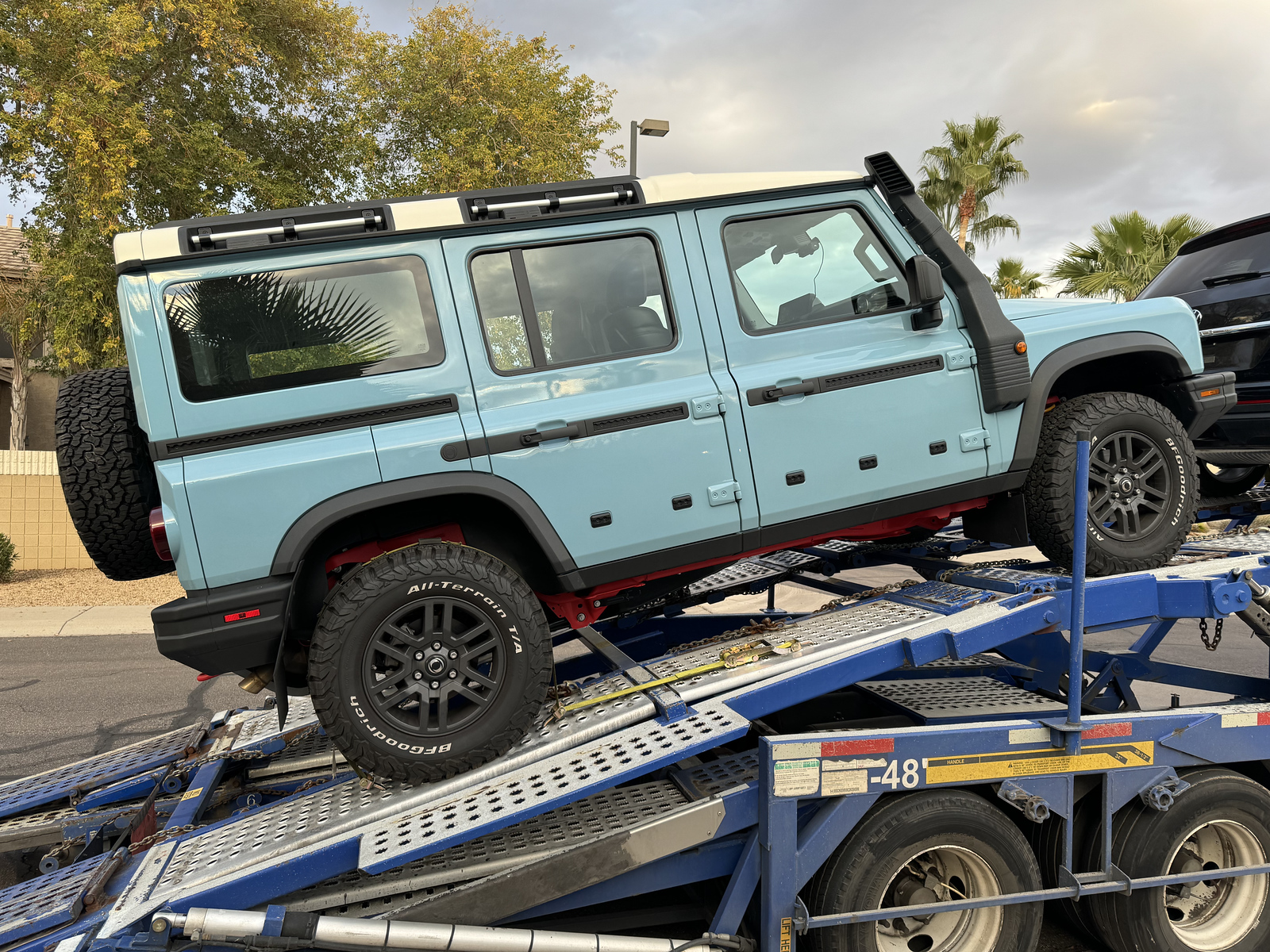

So I've been unable to drive my IG for the past 10 days because it has just been too miserable having the heat on non-stop. Eliott Bay Ineos in Seattle has been very good and gave me some trouble shooting tips but sadly none of them worked. Today Eliott Bay arranged for a truck to come pick up my IG and take it to my nearest dealer, Mossy Ineos in San Diego. Hopefully they can fix the problem.
Ironically the title for the IG arrived today as it was being loaded onto the truck :( (As a side note, the Hyundai Palisade that I rented to cover for the IG while its gone is a surprisingly nice vehicle.)
