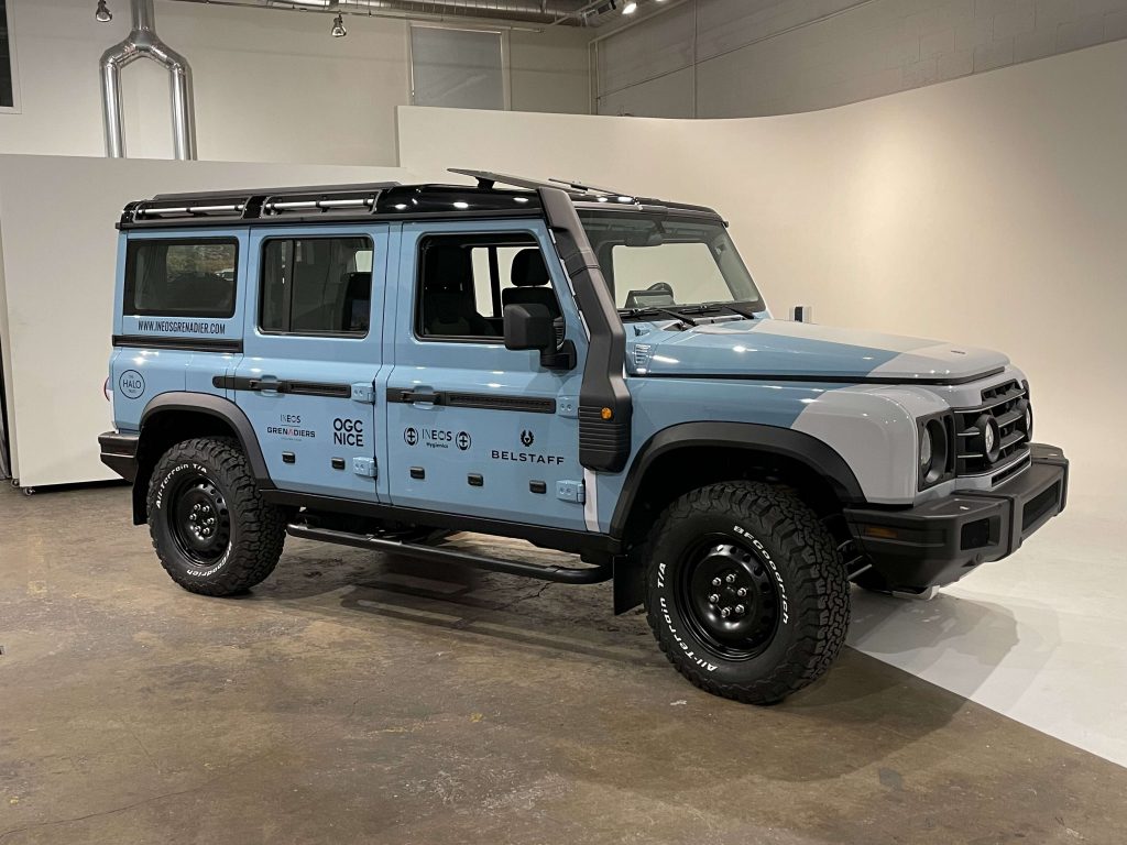

Yeah - you are going to lose a fair amount of ground clearance with the Ineos side-steps. To me - it looks like a lot - unless they've changed the design. Maybe someone with the side-steps can provide a photo if they are different than these:
But even worse, if you come down on those side-steps onto a rock, it is possible that the rock will drive the side-step into the bottom of one of your doors, and do some costly and/or inconvenient damage to your vehicle. I've seen a handful of vehicles damaged in this way. In most of those cases, the vehicle probably would have gotten through the rocks unscathed if they hadn't had any side-steps. Of course, rock-sliders provide great protection from similar rock strikes, but otherwise - they sort of suck. They are heavy - so they reduce your payload, They can make it harder to get in and out of the vehicle; you'll probably drag your legs over them as you get out, and get your pants dirty (probably the reason I no longer get invited to gala balls). Lastly, most sliders don't offer a surface that you can use as a step, so they aren't very useful in that regard.
My suggestion: If you are going to regularly drive in the rocks, get the sliders. If most of your off-roading will be on forest service roads, in the sand, etc. and you need a step, get the side-step. If you are planning a day in rocky terrain, you can always unbolt the side-steps and leave them in the garage.

Those side steps look the same as my factory ones. You do lose a bit of clearance along the wheelbase but imo it’s manageable for most situations except (possibly) rock crawling which I’ve not done for years.

So it depends what you mean by ground clearance. If you get down low and look side on, they are not really lower than the lowest points of the car. So in that sense you aren’t losing overall ground clearance, or more specifically ramp over for a ledge or log for example. However there is no doubt that in the wheel track you do lose some significant sill clearance so if you put a wheel on top of a rock and come down on it then you will hit on the side runner significantly before you will hit the rock slider for example

The side runners on the Grenadier are very much more robust than the OE side steps on just about any other vehicle I know, they are very solidly mounted and made of a decent steel, they won’t just fold up like tinfoil or block your door etc like those will, they are going to take a decent beating. Having said that, they are not rock sliders and it will be possible to damage them if you try hard, the upside if that because they stand off a bit from the car they may help protect you a bit by keep the side of the car a bit further out from rocks and trees etc. if you are truly going rock hopping they aren’t for you, get sliders, if you are doing bush tracks, sand, mud and general touring with a bit of offroad my call is that they are great.
Also if anyone who will need to get in and out of the car regularly is not as dedicated to offroading as you and or has any kind of mobility issues or are shorter. They will curse you every time they have to get in and out if you have sliders from INEOS or no sliders or sidesteps at all. I am 6’2” and the couple of times I have had to get in or out of Grenadier side steps. Even I have found it more challenging than I expected. So if you decide the side steps art for you, then don’t get the INEOS rock sliders look for an aftermarket that includes a step..
