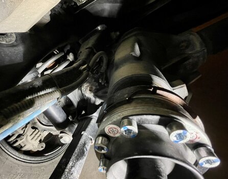

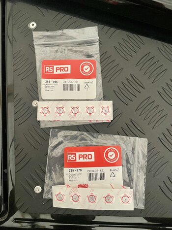

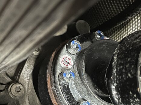

Today I mounted irreversible heat-seals on both four CV joints to see how hot they get. After about three hours on the highway at about 100 km/h, this is the result: front CV joint on the transfer side 60°, all the other three below.

I checked the joints with an IR gun after high-speed, summer, highway runs - they were always barely warm.

I did this with heat sensitive paint. Everything was in spec.
