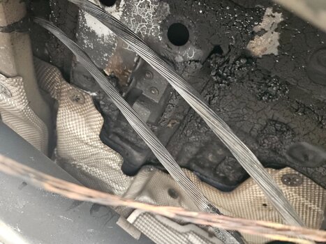

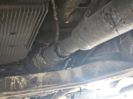

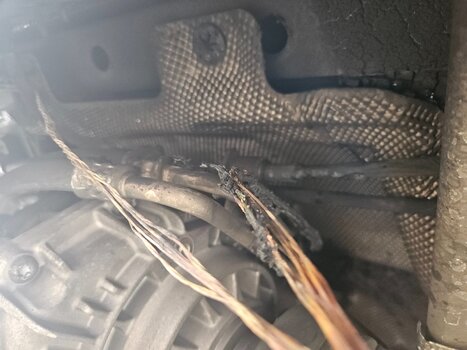

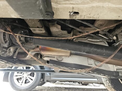

Went to the tow yard today and got photos for insurance fire claim; found the drive shaft busted open which confirmed a lot of what I'd been being told in threads today.
All the wiring under the carriage is completely toasted so it's not a pure mechanical repair. No clue how much fire and water got into the cases either as FD had to use the hoses.

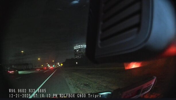

The flames were surprisingly significant for this kind of failure. Dash cam I have only covers front/back, not sides, but you can see the reflections of the flames around the passenger side door in the windshield glass. Glad I had a Halotron extinguisher with me to get it subdued before it spread farther until FD showed up.

Some photos. Getting them at the tow yard wasn't ideal and my phone can didn't like trying to focus on stuff
But photos of the driveshaft, wiring. Etc. and one from the dash cam where you can see the passenger flames reflecting in the glass a bit.
These shaft failures are no joke. It's also amazing how much that electrical wire conductor elongated under heat.
