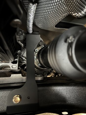

Others have mentioned a driveshaft protection loop/hoop offering some level of containment should a catastrophic failure occur. How about a loop which simultaneously holds the Bowden cable out of the way and constrains the driveshaft should it fail? Seems like Agile’s Bowden cable bracket solution is almost halfway there… it would have to be a considerably more stout version of it though.

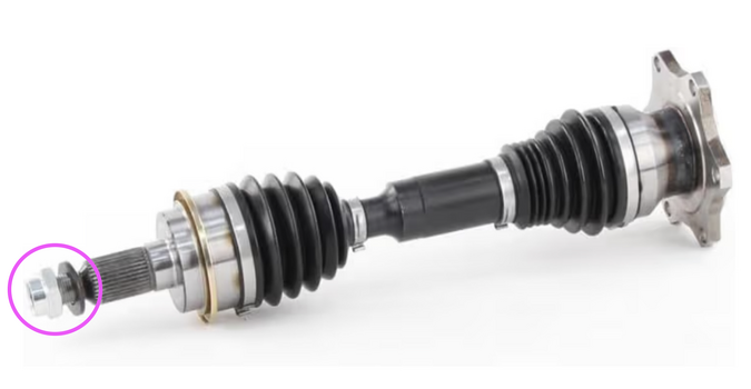

I think one possible solution to the problem of the shaft coming out of the CV joint is to replace the C-clip with a bolt like the one I posted earlier.
Why delegate such a risky and hard work to a C-clip?
I'd prefer something more beefy than a circlip. We should not have to need it but clearly do at ghe mo!
the c-clip shouldn't be an issue. I'm wondering why it is. People that have had the c-clip fail, actually found it, right? As in, it was there to begin with.
The photo you posted is of an axleshaft. It still uses C-clips in both CV joints, and the "bolt" is the attachment to the hub.
A retention bolt instead of a c-clip would certainly work better and last longer between failures but the core issue still remains. No matter what retention method is used the overall design of the front end is still allowing the impacts to it to take place. Given enough whacks the head of a retention bolt would eventually crack and fatigue as well I would think.
Yes, it was an example. But the first time I disassembled my CV joint, I actually thought a screw would be safer than a clip. In fact, a few kilometers later, it came loose...
The problem is the limited space between the end of the shaft and the flange, but I think it can be solved by redesigning the shaft or even modifying the existing one.
Just what I am planning on my little fabrication project
