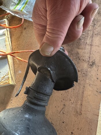

Further inspection shows boot damage not noticed before. Could've easily happened before or after circlip let go.
