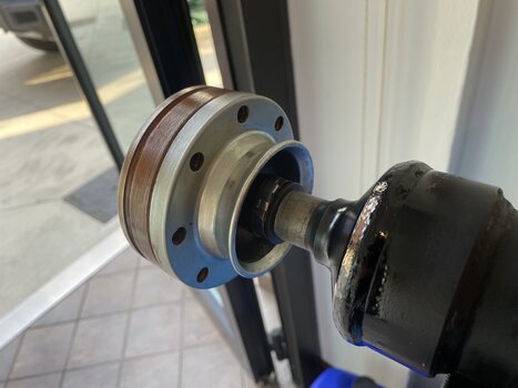

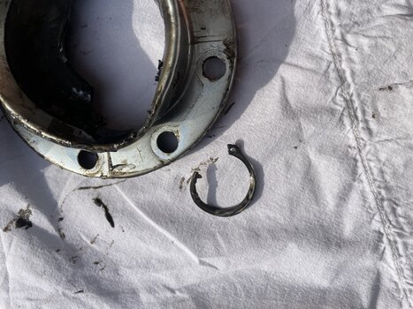

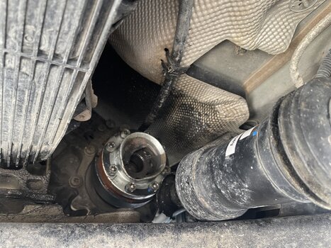

I removed the shaft, and fortunately, I managed to get home without any damage. After removing the teraFlex CV joint, which had been installed just 2,000 km ago, I noticed that the snap ring that holds the shaft in place had failed, causing it to pop out. The original CV joint, as already mentioned, was inserted by interference, while this replacement for the teraFlex went in very easily. This probably caused the force to be completely discharged onto the snap ring.

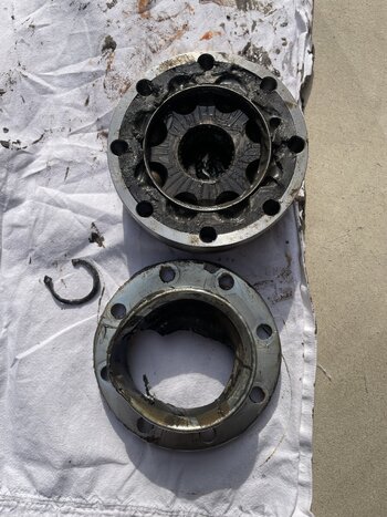

I have seen stock CV's slip off and on just like the Terra joint. Mine was moderately firm. Regardless, there really shouldn't be any force on the snap ring at all.
Since the teraflex joint fits too loosely without any friction and since the teraflex boots are compatible with the original joint, I reassembled the original joint with the two teraflex boots waiting for someone to find a definitive solution

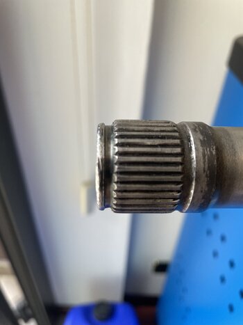

I can't recall if you repaired the shaft from a previous failure with the Terraflex joint and the damage was caused then but the circlip groove on spline on the shaft in the photo appears unserviceable now. There is a radius/chamfer on the face of the circlip groove the circlip has to work against. It is quite likely the circlip is going to come off again. Circlips generally have a flat side and a slightly curved side from when made, its a good idea to place the flat side against the side of the groove that will take the most load.
And the splines look "unwell" to me
From the pictures it looks like the clip groove is chamfered or worn on both the spline side and end of the shaft side. There is going to be both push and pull tension as the driveshaft tries to slide fore and aft in the CV joint splines during axle compression and extension. Those chamfered or rounded edges are going to act like small ramps which the clip is going to ride up effectively trying to open the clip as you would do when removing the clip with c-clip pliers. Do that a few thousand times as everything moves about and it's possible to imagine the clip flexing enough to fatigue crack and split in half.
Yes, I recently installed the Teraflex 1745000 cv because the original boot had broken.
Given the condition of the spline I ordered a new original driveshaft hoping he has better boots.

Given past experience and how the CV joint works, I would not advise anyone to fit replacement joints that do not jam like the originals, otherwise all the load will be placed on the circlip which is not designed for that.
Well that's the problem, they don't all jam on. The one I helped a buddy on recently came off in his hands before I could get him a mallet or put it in the press. The factory part literally just slipped off. And the Terra just slipped back on. I am leaning towards peening the splines a bit on my next one.
