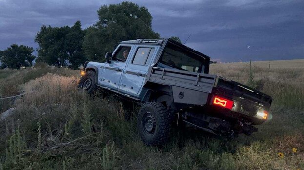

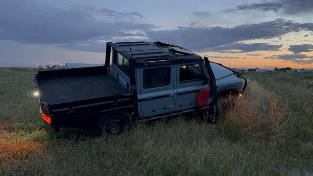

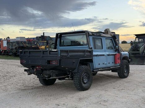

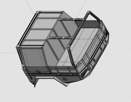

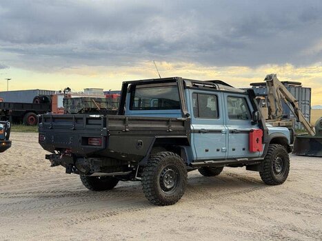

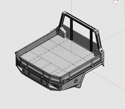

Here are some pictures of the Dirtbox tray, some tweaks and order books will be open. I have asked if they could color match the half canopy doors and the under tray doors plus the side boards.

I called Couch off-road to learn more about the tray and spoke with Jay Couch. He spent 30 mins giving me the low down. He is more than excited about the outcome and I am on the Dirtbox train. I wish I had a transcript of our call as every second he gave such good info.
Off of memory.
The size: he has extended the tray to over 6 feet in length and width is same size as width to door handles.
20 gallon water tank
Spare tire is mount under the bed with a slide/box to hold it. It opens
19/20 gallon spare gas tank with ability to fit another 19 gallons by head rack.
The frame sits on a sub frame 3 point sub frame. The reasoning is the QM chassis is very stiff. He wanted to minimize flex between the flat tray and bed.
Rear winch mount, his test winch is 13k
With the added weight he is going with 1000 springs.
Here are some pictures of subframe, the spare tire hatch, rear winch
He has my attention for the spare tire location alone

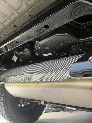

Spare tyre location would be affected with the AdBlue tank that sits in that space on the diesels. Looks good though, and would match my

Nice looking set up, I like the spare tyre location and rear winch set up. The tray looks a bit flat pack like a lot of alloy trays available in Australia. I didn't think the QM had that much chassis flex to need a heavy 3 point mounting system like an expedition truck.
When I spoke with Jay, he mentioned you could order it without the subframe. But it's only 1200 for the subframe. I need to learn more about sub frame but I wonder with bigger springs, how much your gvm goes up?
Donney Grey QM
He mentioned being able to put a 19 gallon tank in the head rack. That might be a solution to add tank. Then a custom def tank where he was talking about a spare tank between the wheel and frame. When I talked to Jay, he mentioned he has to move the petrol evaporator tank where the spare goes anyways.
He mentioned being able to bit a 19 gallon tank in the head rack. That might be a solution to add tank. Then a custom def tank where he was talking about a spare tank between the wheel and frame. When I talked to Jay, he mentioned he has to move the petrol evaporator tank where the spare goes anyways.
There might be room behind the exhaust. Just remembered that the AdBlue tank is above the exhaust muffler. Extends down to the bottom of the cross member or around 100mm.
