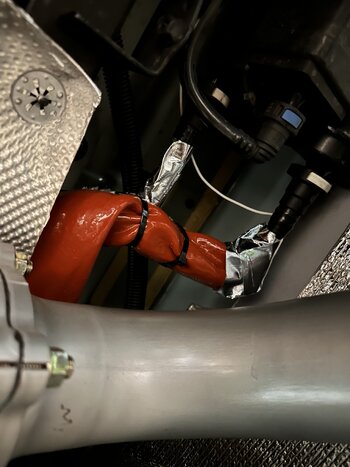

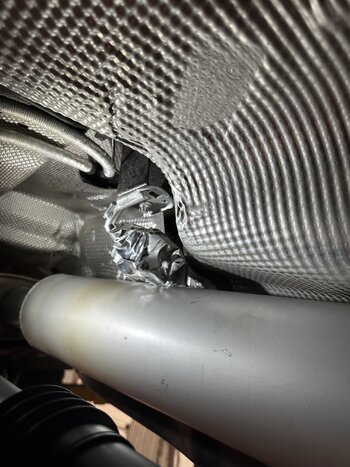

Additional heat shielding was applied during our LRA Auxiliary tank install.

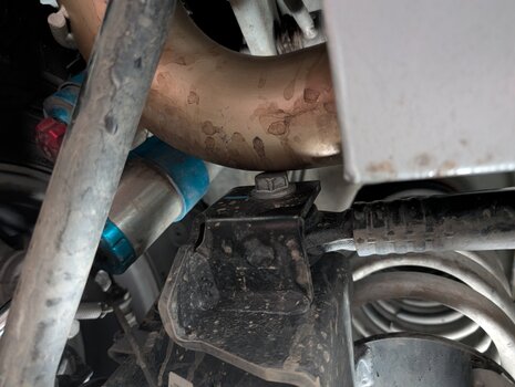

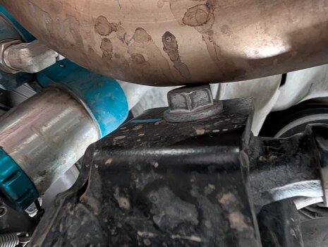

Does anyone else have theirs hitting their I think its a control arm on the rear axle??? My rear muffler swings back and forth so much it makes contact?
On my truck the clearance dent on the exhaust pipe still contacted the rear suspension bolt on certain driveway entrances; the fix would have been to make the clearance dent in the pipe a bit larger

Yeah let me work on getting some pics, I actually want to go the opposite, basically take all the cans out... lol I'm actually wondering if they can even get the rear exhaust out now without dropping the fuel tank??

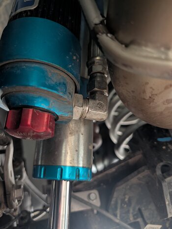

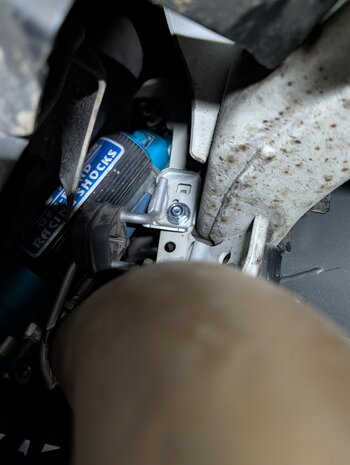

So the first pic is the Kings shock it will hit that but it take quiet a bit to move it that far and has to be a side to side motion. The other pics is the rear axle control arm bolt always touching it, looking around I see no way to move the exhaust toward the rear to put space there. It also moves around a lot due to the rubber exhaust hanger connections. No way to remove the exhaust without dropping that tank.
I’ve just read the installation instructions. Is this the same bolt ?
Yes that is the bolt you have circled in red.....
I’ve checked mine this afternoon and it’s clear and not fouling anywhere. It seems you are tighter for space with those aftermarket shock absorbers though
Are all your exhaust hangers in place as my exhaust doesn’t swing around at all.

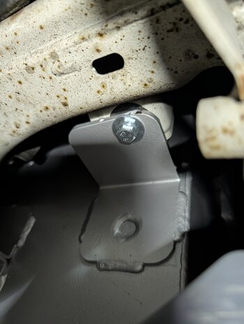

Yeah with the shock to exhaust is about 25mm clearance and not sure if there is any real contact there. The issue I think mine is having is it is in contact with the axle bolt for the upper control arm. Funny thing I just noticed is our swing arm mounts are NOT the same..... Look how beefy mine looks and yours looks stamped... Weird. FYI Mine is driver side LHD model so not sure if there is any difference there. Also my exhaust does not have a dent in it to clear that bolt head....

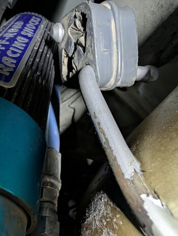

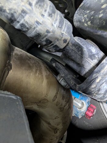

Had some time this AM to look again... Something just isn't right here... My exhaust does have the dent for the both head but it isn't close and it looks as though the tank is resting on the AUX tank too.... Obviously need to take it back in to have re-work done just have no clue how that ended up like that.
PXL_20251227_155113451.jpgPXL_20251227_155241147.jpgPXL_20251227_155244801.jpgPXL_20251227_155308811.MP.jpgPXL_20251227_155324427.MP.jpg
Doesn’t look right. Whats causing the abrasion and scuff marks on the exhaust and hanger in that second from last photo.
