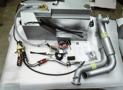

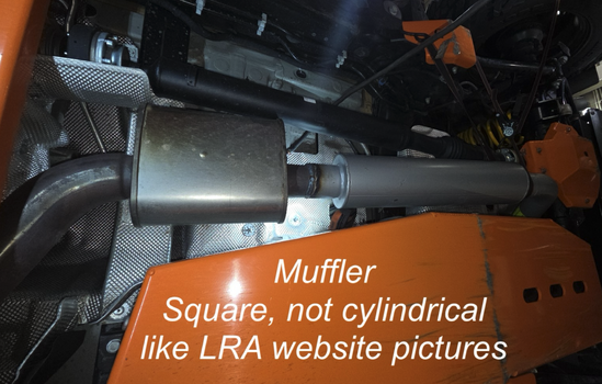

The in-line muffler that is shown on the website is different than what was delivered. I believe they are different in the USA from AUS. That could be the differnece.

Interesting, maybe a running change or maybe a difference in local regulations.
It would also hurt to replace parts of the exhaust with coated steel whereas the OEM exhaust is all stainless. So not just the sound to consider.
