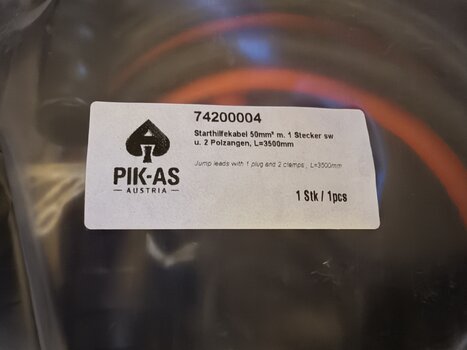

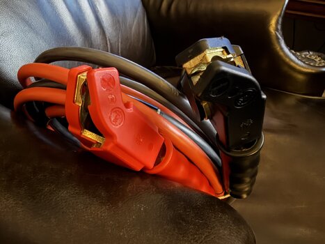

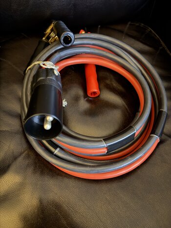

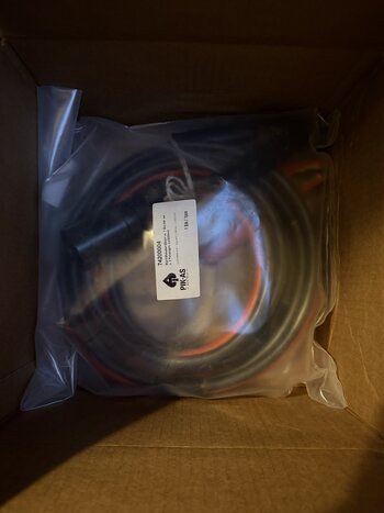

Just wanted to highlight that AO now offers a Jumper Cable with NATO plug to make use of our NATO connector. Got mine delivered today, cool stuff!
