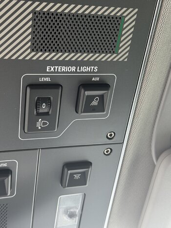

Hi all,
Looking to do new grill lights and roof rack lights. I want these to be controlled independently of each other. I’m not wanting to run a switch pro or aux beam as I’d like it to be stock. I don’t have the upgraded aux switch kit.
I would like to run the grill lights to the original aux exterior lights button and run the roof rack lights to the aux 1 switch.
Has anyone done this yet? I’ve seen some other people mention it in here but haven’t found a solution. I want to run the lights without being in off road mode or using the high beams. I understand that this likely wouldn't work through the computer of the truck, but what about disconnecting the button itself and using it as a hard switch to the lights?
Any help or input would be great before I start ripping everything apart.
Thanks.

It’s doable.
I’ll try and take pics of mine shortly. But it’s not quick or easy. Basically, drop overhead panel, splice in small pilot wire, run wire down A pillar to under hood to a relay, get power for relay from the battery point. Now choices, either cut the wire leads off the lights and make a harness, or open up the main harness, cut the wire in the harness and splice at that point. But it’s not straight forward.

Definitely doable.
I would unplug the existing wiring from the existing switch and check which pin does what.
I would then feed the 12v to this switch by tapping into the output of the power switch in the roof panel.
Then take the output from the aux switch and feed a relay module. It will need to be a Single Channel Latching Relay Module as the aux switch is non latching.
You would need a 12v supply to this relay module of course.
Then feed the output directly to the aux lights and roof lights.
Routing the wiring and deciding where to mount the relay module would be hardest part!
I know this is a slightly old thread ... but .. I have done it a different way... tap the body computer output(under the steering wheel). This is the line that drives the grill Aux lights. Run the tapped line around to where the high power relays are.
Add another relay and use the line from the Aux lights to drive the relay.
Remove(or cut) the Ext1 hight power out off the high power relays/fuse block. Wire the cut EXT1 line to the new relay and supply fused power to the relay.
This means the roof outlet for the light bar will come on when the Aux grill lights are on, including high beam integration.
You then have the Aux 1 switch available to use elsewhere... (I wired up starlink power from the cut output of the high power fuse block)
