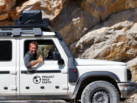

60,000km INEOS Grenadier Write Up After Driving it Mainly Off Road Around Europe and Asia For The Past Two Years
I wanted to share our experience to contribute to the community, but also because everyone on here and in the Facebook groups writing about their experiences has been incredibly helpful from our side. This is a new vehicle and so to see what’s going on around the world has been great! I hope people will find this useful. :)
We have an INEOS Grenadier Trialmaster Petrol with a few factory options. Everything else is pretty much standard. We’ve done close to 60,000km. About 75-80% off-road, towing a Patriot X3 Trailer
