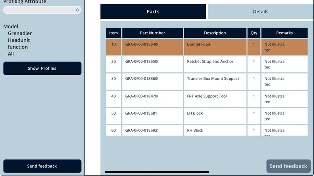

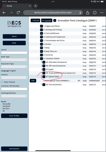

Does the manual have a special service tool list. May need a few for some common jobs.
There is a list of 135 SSTs in the IPC. Listed by PN and name but no illustrations or photos and no cross reference to where they are used.
135 SST out of that there is only a few most people who do their own work would need.
