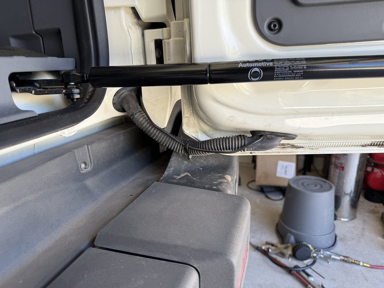

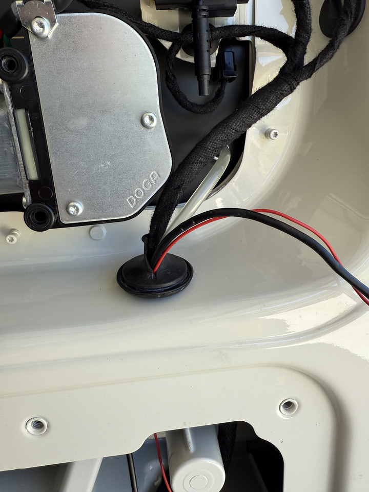

Of course, I loss sleep knowing that I ran the wire outside the back door, so I had to fix it this morning.
If you notice here this grommet includes the water line for the rear washer. I did not want to compress it in anyway, so I put a split in it to run the camera wire.
I then re-wrapped it with the cloth tape I removed.
Because the hose runs through the rubber hose, I left this cable as is. I did not want to disturb the washer hose...

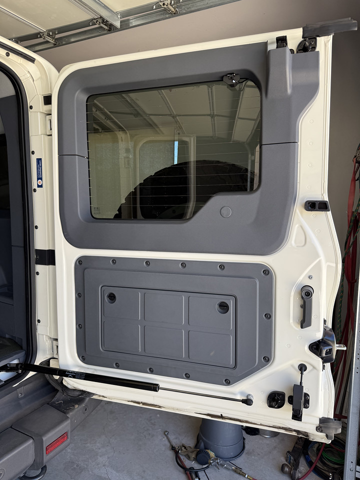

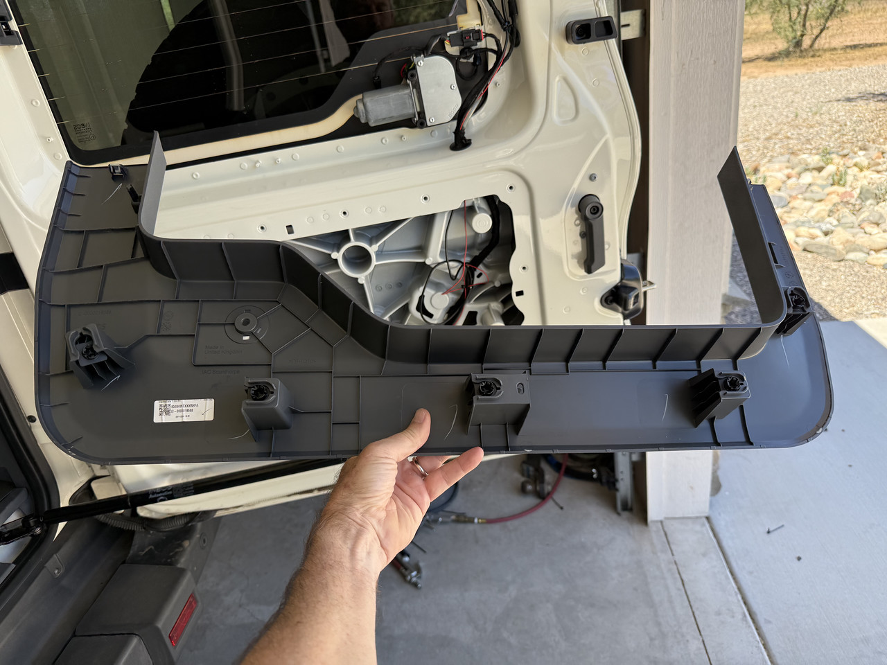

This pic of the door panel may help folks to understand where the clips are and how and where to apply pressure when removing. It clips on the tiny studs in the window frame. Here you can see I re-wrapped the grommet with the cloth tape. I need to buy some, it's perfect to stop things from rattling when adding connectors, or anything in a closed door..
the finished door... I can rest now...
FWIW: The rear camera wire will pass through the rubber boot with the help of a wire snake and some silicone spray w/o damaging anything. Just have to detatch the boot from both ends, cut the tape on the door-side of the boot to expose the boot opening (I re-wrapped with TESA tape affterwards), and tape the camera wire to the wiresnake. Silicone spray, or something similar will allow you to slowly work it through w/o tearing the boot.
I mention it only because the exposed wire may get damaged over time zip tied to the outside of the boot🤷🏻‍♂️
