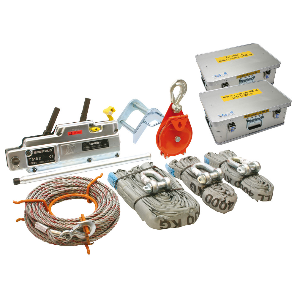

The hand winch you appear to have selected is enormous. I assume it was just to illustrate the type rather than the model?
I use a Greifzug with my Defender. The good thing about it is that you really think it over before you bring your car in a situation where you need it. It is slow slow progress you make, working with it!
But it is somehow satisfying as well to see what you can move with one arm…
My tirfor is quite heavy and needs two aluminium boxes including steel rope and everything I need for it.
Have you got some photos of that setup?👍
You're right, it's a monster.
But I simply (as naive in this topic) chose one with about the same pulling power as the integrated winch. I've since learned that a 1.6 ton Tirfor with a pulley would probably be good enough.
Also, you probably don't need 20m of steel cable. What you need is a cable with approximately the net towing length normally required. You can extend this to the car with a plastic cable. Saves a few kg too.
Another thing is weight. A good Tirfor (say 3200Kg) and a cable quickly sums up 50 or 65 Kg, depending on the brand and the length of the cable. The cable has to be made of steel due to the functioning principle of the Tirfor, so it is quite heavy. A short steel-cable would however work if you extend it with a plastic rope and only use the steel part for winching. This saves some kilograms.
Maybe it's better to transport 65 Kg for 10% of the time than 45 Kg for 100% of the time. But you have to secure this load whilst driving, it can become a dangerous missile.
There was another idea: The removable winch. Works front and aft. Does anybody know what it weighs?
Don't forget you're looking at lifting loads with a Tirfor spec.
A T516 should be more than enough. Weight wise the machine weighs 13.5kg & 20m of cable 13.1kg. Carried separately or together, it's not a issue.

No, sorry. But here is the bundle in a shop:
Thanks.
UK suppliers don't seen to bundle in this manner.
I like the edge separator, but it doesn't seem to be available separately?
