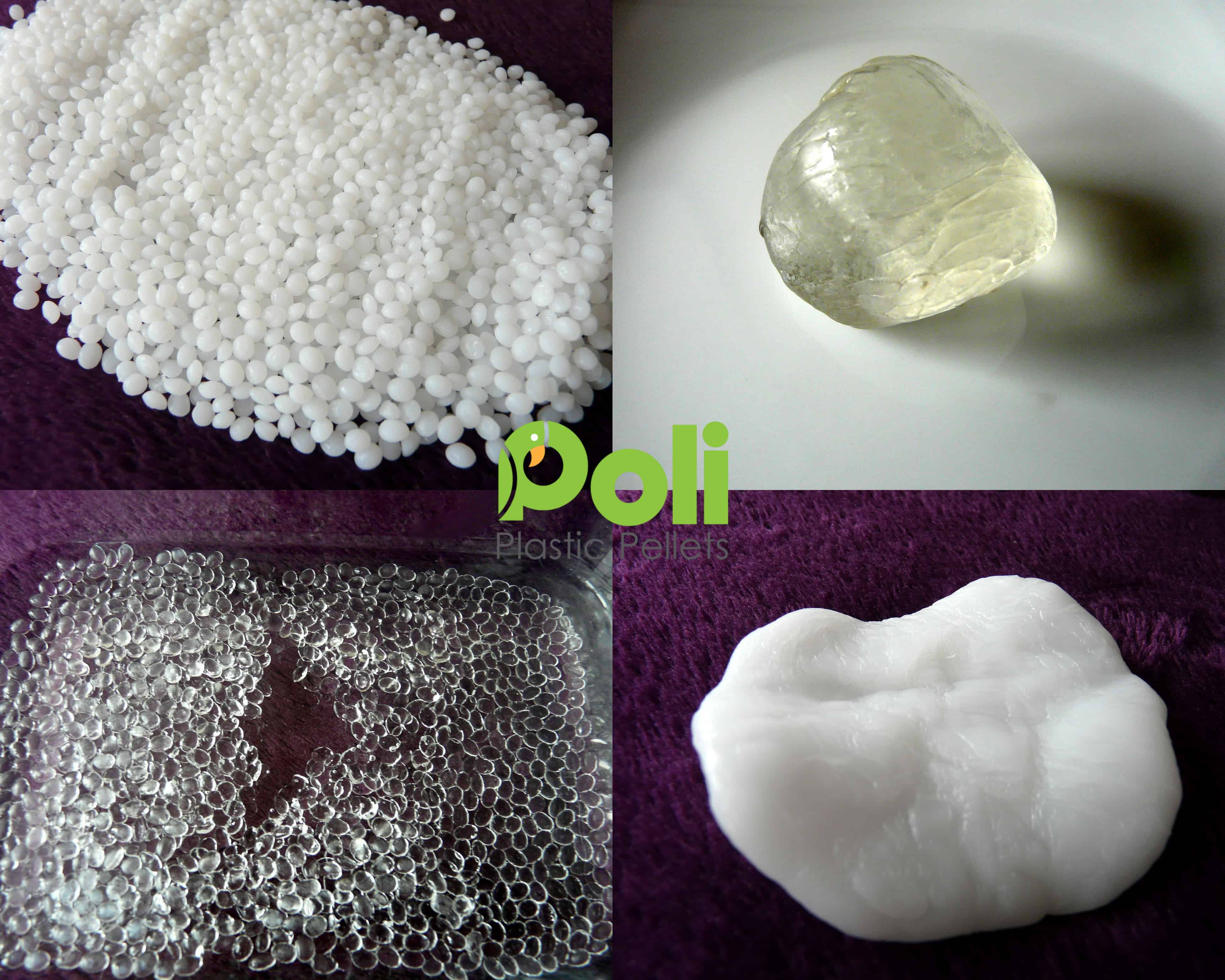

Further items I keep in my repair kit are JB Weld epoxy two part adhesive in various guises and a packet of polymorph plastic pellets, the most amazing stuff once formed you can saw it, file it, drill it etc to make any small parts. Just immerse in boiling water to mould into any shape , can re use at any time by re boiling. Great for broken switches and knobs etc.
Windscreen chip repair kit.
Kit is all packed away in the garage so trying to wrack my brain as to what’s in it.
