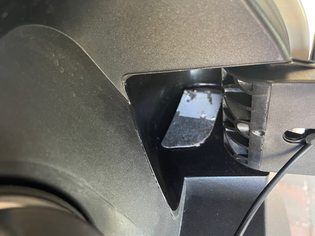

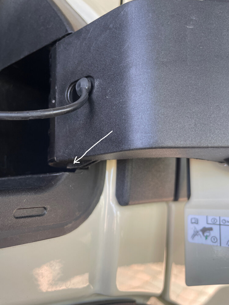

The fuel cap cover drops a couple of millimetres towards the back of the car and doesn't follow the wheel arch.
I have been working out a way to line up the Fuel cap cover...being a designer things in my brain have to line up as they were made to...It has annoyed me since I saw the prototypes and thought that would be sorted by the time it's in production...Looking at the cover hinge I noticed a lug at its base...I created a wedge using a light galvanized steel plate, by putting a crease in it...I played with this till I had the right lift I needed...so when I close the cover that lug slides up the wedge lifting the cover to the right height...this is my prototype that is held in place with Wurth double sided tape but it works for now and probably will be 3D printed and held in place with sika...it is easy to see this fault on the lighter coloured cars...once I have made a proper pattern I will again post on here... (y)
I have been working out a way to line up the Fuel cap cover...being a designer things in my brain have to line up as they were made to...It has annoyed me since I saw the prototypes and thought that would be sorted by the time it's in production...Looking at the cover hinge I noticed a lug at its base...I created a wedge using a light galvanized steel plate, by putting a crease in it...I played with this till I had the right lift I needed...so when I close the cover that lug slides up the wedge lifting the cover to the right height...this is my prototype that is held in place with Wurth double sided tape but it works for now and probably will be 3D printed and held in place with sika...it is easy to see this fault on the lighter coloured cars...once I have made a proper pattern I will again post on here... (y) View attachment 7830469
Fantastic Max... yes stands out on the white cars, can I put in an order now please?... missus reminds me of this every time she sees it. Yes I know... but... 😁

Not that I have received my truck yet, but it will drive me nuts if it's noticeable. As I have asked others, please share the stl file should decide to 3d print. Thanks!
Your wife has a keen eye...I was very conscious of the top of the cover lining up with the track above it and I still think I could take a thou off the paint on the wheel arch side...splitting hairs is in my nature...I will keep on it... (y)
Look at the photos posted and there it is...sorry Krabby it is noticeable...look at the light coloured(y)
The little lug I pointed out may be the issue and should have been a little deeper and touching the cavity as it moves back into it...anyway we have what we have...on to it(y)
I'm yet to find one that lines up properly... all made of plastic including the hinge from memory and with the weight it just... shall we say.. droops... no adjustment available that I can see - go Max.... 😎
