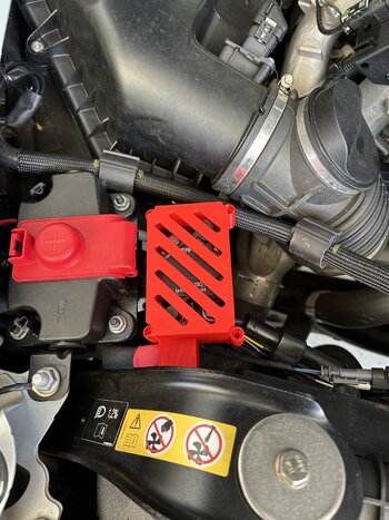

I have been a bit wary of the exposed 12v at the winch circuit breaker adjacent to the jump start post under the bonnet. To easy to drop something onto.🤨
So I designed and printed some protection.
Came up ok and isolates all the hot 12v parts.
This is the last prototype and will print the final version in ASA and probably in black.

Nice! Will you post up the final file?

Red still seems appropriate (and in keeping with the cover of the adjacent 12 volt post), considering the risk…

Now _that_'s what I call useful!! There are more (and possibly dangerous) exposed live metal parts around the starter motor etc.
As far as I understand, if you short such an (unfused) high current live part to the body, the pyro braker at the battery terminal will blow, "protecting" you but leaving you stranded.

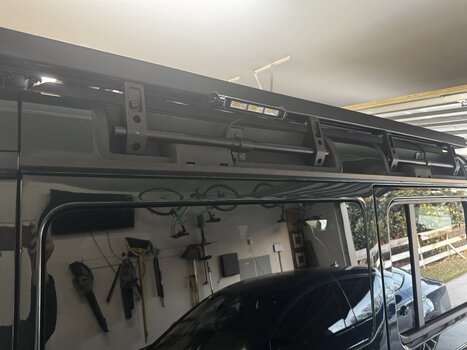

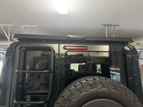

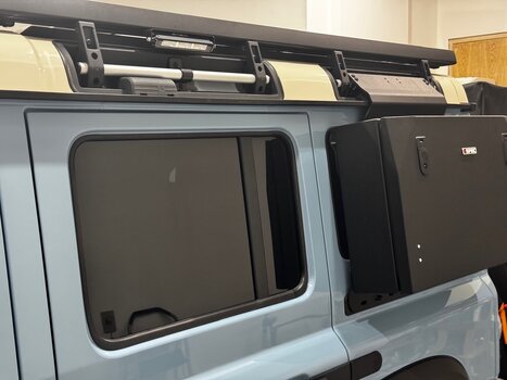

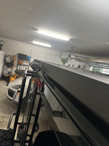

This convinced me to free up the grab handles and mount the lights directly to the bottom of the Leitner rack with some Amazon L-brackets. Rear light bolt barely clears the roof, but so much more practical. Thanks for the idea!

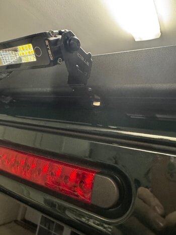

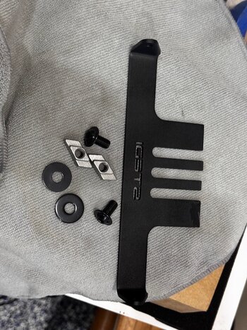

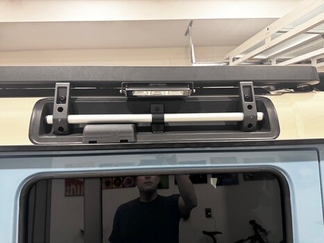

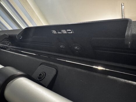

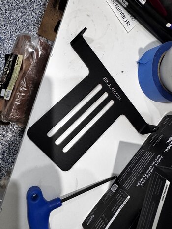

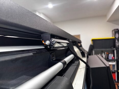

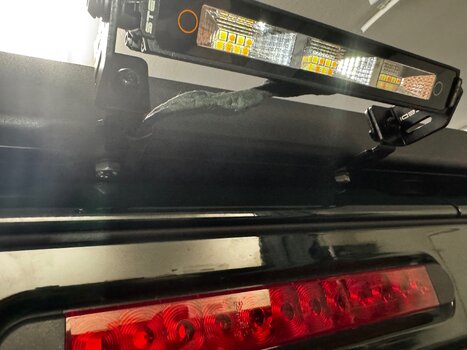

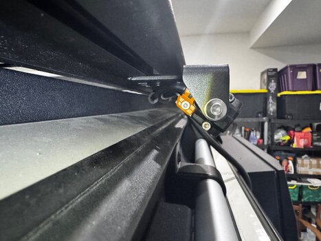

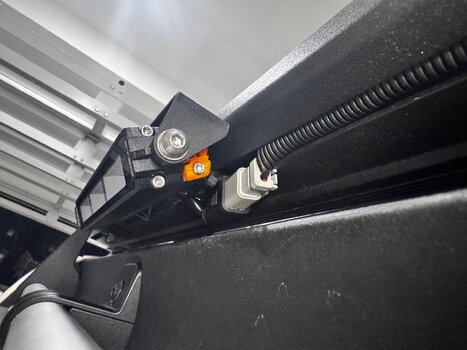

I did the same but used the stedi mounting plates… just cut them short to fit. These are the best option on the market for camping lights if you ask me :) very versatile with white/yellow and individual dimmer for each color….

Looks great
Those are the same brackets I used & also had to cut the side ones short as they wouldn’t slide over/past the rub rails on the roof. Took a few extra minutes of cutting but otherwise a clean, easy install.
Haha! I bought the Stedi brackets, and just as quickly realized they were 4” too deep and I’d end up chopping them up 😂
And then I realized they are sold in two packs and I needed three.
I found these on Amazon. they are nearly perfect, maybe 3/8” too deep, and the lights set a bit more proud of the rail than they could. But just fine and I didn’t have to hack up the Stedi brackets.
They are a great light. Really surprised they aren’t offered by Stedi US directly.
