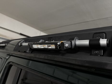

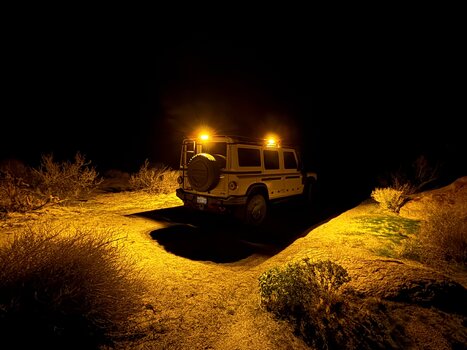

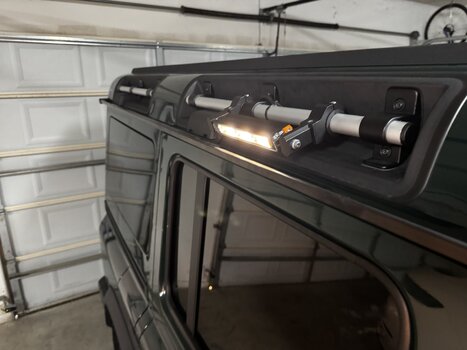

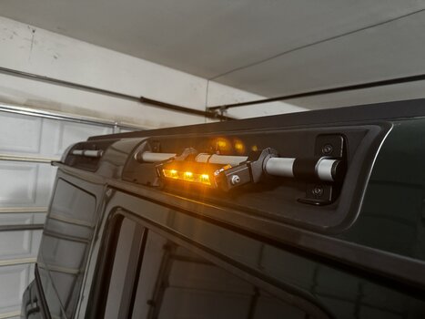

Which side lights are those on your grab handles?
Are you happy with them? And where did that mount come from?
They are great. Like Scotsman said, the dual color and dimming are great options to have.
Link to mounts
FYI shipping is a little high from Stedi UK, order them all at once and will be cheaper. There will be duties due to DHL once they hit the states. I think they ended up being ~$120-130 all in after everything
These are fantastic-looking. Thanks for sharing. I think I will order, but shoot the mount bolts & washers with a bit of black paint. These almost look like OEM parts.
all black would look great. I hit the plastic orange accents with satin black paint, may eventually do the same with mounting hardware.
They are fitted with DTP connectors, so you’ll need to splice in a DT connector to mate with the roof outlets.
I eventually got smart and just clipped the light wire and replaced with a male DT so I didn’t have multiple DTP/DT connectors in the same run.
I have the two-tone from ABNTR4x4 as a plug&play set with mounts, Deutsch plugs and wiring. https://shop.abenteuer4x4.com/stedi...plug-play-seitenlicht-set-ineos-1-323-lm.html For camping, warm white only might do: https://shop.abenteuer4x4.com/stedi...lay-lichtleisten-set-fuer-ineos-1-400-lm.html On the pictures, there is cold white on the left and warm white on the right.
Will these fit around the grab handle with the electric connection? Or must they go on the empty handle?
At least with the mounts I used, there wasn’t space laterally (front to rear of car) on the grab handle to mount them above the electrical plug box, tolerances are tight top to bottom and front to back in that section.
Total front to rear for the work light with the grab bar mounts is likely 9-9.25”, and the height of the electrical box might impede the light/wiring unless you pulled it way out from the body and/or printed a shorter box (which someone recently did). It might be possible with a really thin mounting system and some garage engineering.
Alternatively you could mount them to the rack if you have one up out of the way, or even the drip tray if you want to keep grab handle real estate.
