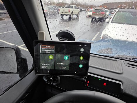

3. tiny rig device holder - except for the silly square socket screws, a nice unit, I only have 67 Design bases right now, they aren't really meant to attach to a flat surface, will have to look at RAM mounts.

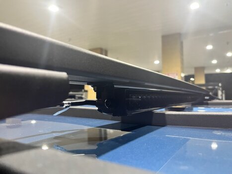

5. DVA Mechanics set of 4 roof rails - super nice low profile crossbars. I don't really need a full roof rack, so the crossbars are a nice alternative.
The big downside, for me, with the DVA crossbars, is that with 4 of them, the rear ones attach in the exact point where I want to put the DVA brackets to hold my 4gal Rotopax over both rear windows. I can mount the Rotopax flat on the roof like I had with the land cruiser, or I can remove the rear two crossbars. Haven't decided yet, but an interesting thing to note for anyone else considering DVA Crossbars and the DVA vertical rear window mounts. They're all nicely made, too many tiny effing screws though, but other than that, nice gear.

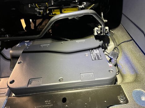

Grenadier with 150 amp hour RedArc battery and 2000W inverter running my sons refrigerator for 13 hours when Xcel energy cut off power for 16 hours due to high winds. Battery dropped from 100% to 71% in 13 hours, so good to know it will power a home refrigerator for a bit over 40 hours without running the engine.
