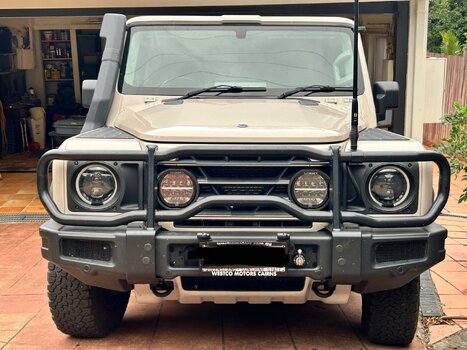

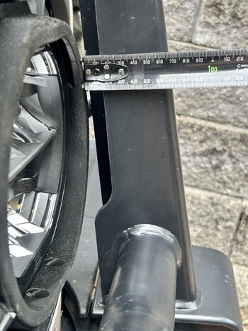

Just installed my Lazers behind a bull bar. Had to remove the bar for installation, which was pretty easy.
Wired them up using the factory driving/aux lights power through a relay. This allows me to use the ceiling panel switch to activate/deactivate the Lazers to come on with my high beam.
Nice…hoping to have mine done by now or early next week. My QM is a Guinea pig for the 4WD shop so I’ll inform them about the overhead switch option you have. Thanks.
Can you share some details or a photo how you have wired it up? I exactly want to have the same behaviour. I want to use the factory logic and enable the aux light to come up as an option together with the high beam.
