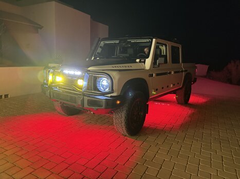

I have the owl mounts + LP4s in the factory location tying to EXT5 25A power source in the engine bay. While doing that, I ran the Triple R hidden light bar to the EXT1 10A pair right next to them in the engine bay. The daytime run function is stellar on both, and the LP4s throw a crazy amount of light from the factory location. It’s a very clean looking install.
The LP4s with the drive combo lens give a good amount of throw to the sides, and I really haven’t found a need yet for dedicated ditch lights.
Does the light bar provide additional coverage in terms of spread or range? Do you find it redundant at all or supplemental? Trying to find the best combination of lights and the light bar in elite plus form is very compelling.
Redundant from a coverage perspective. The hidden light bar provides a sweet daytime run profile when not running on full power mode, but that’s probably it. The LP4s are just so effective at throwing an obscene amount of driving light midrange. Supplemental would be adding 2 additional LP4 spot lights for better long range throw, but the cost on that in significant. I’ll let you know how the 2 driving LP4 and 2 spot LP4 configuration works once I get the spot lenses installed.
FYI though, I would just buy clear LP4s if you find yourself in a 4 LP4 situation. Spot and driving lenses are only available in clear; amber lenses only some in driving and 4 of those seem super redundant. Plus, you can always add amber rock guards to the clears to get the best of both worlds.
Current setup, but making the LP4 changes within the next week or so if work slows down. Rock lights are just for hunting when we don’t want to lose night vision when coming/going in the dark.
I’ll add a visual comparison from the point of view of the driver when completed.
