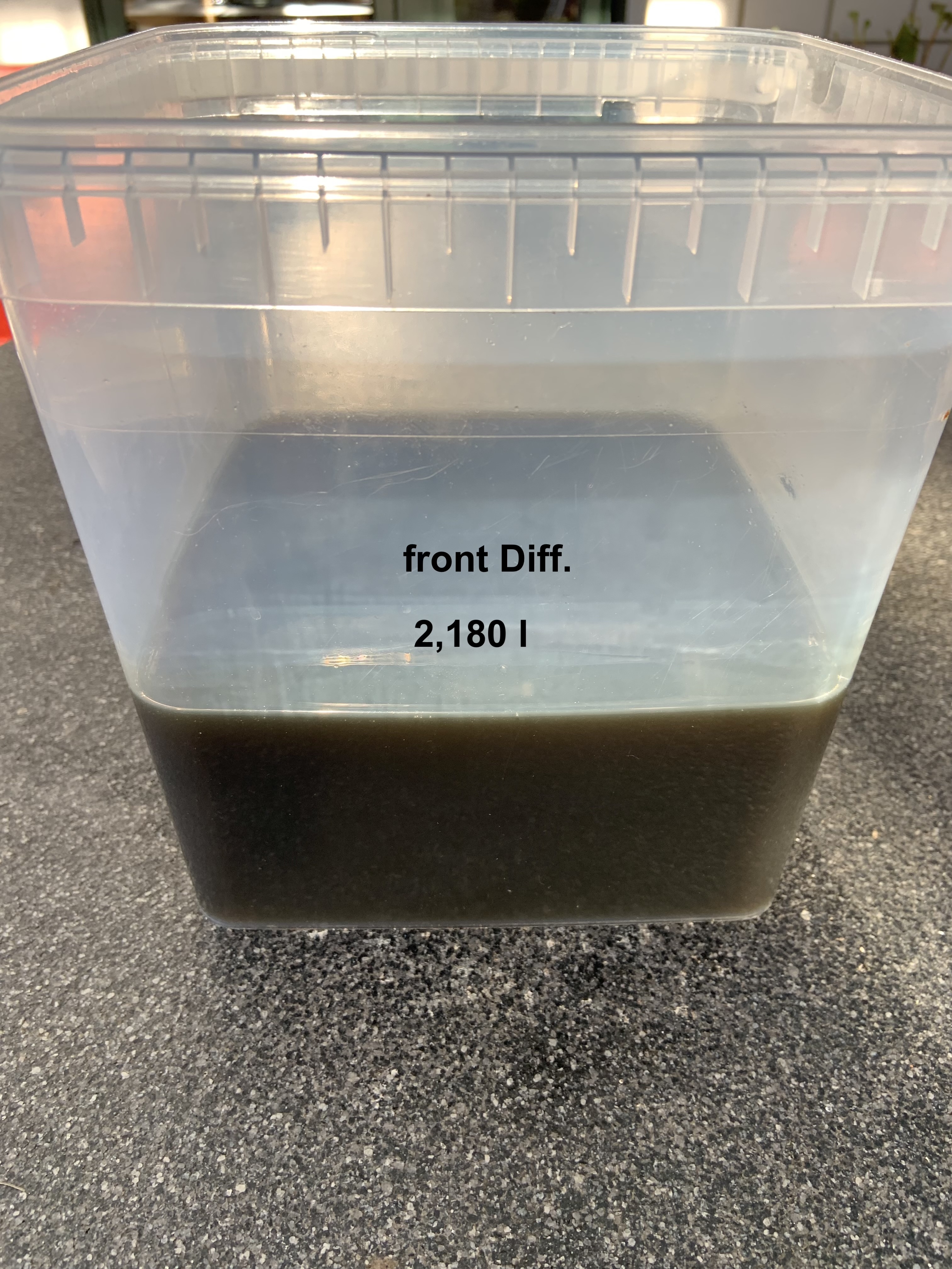

Today I changed the oil in the front differential after 18500 km. After opening the drain plug, 2,180 liters came out, which I exchanged for the same amount of Fuchs Titan Supergear 80W-90. With this amount, the oil level in the diff was. approx. 1 cm below the inspection opening. Tomorrow I will find out how oil is in the rear Diff. For 20 liters Diff oil I paid 85,44 Euros. That's less than 10 Euros for an Diff Oil change. (y)
How did you measure a delta of 1cm between oil level and fill hole?
With a cable tie. However, this method is very inaccurate because the cable tie cannot be inserted into the housing at a right angle. That's why, when I filled it, I initially stuck to the amount that had previously flowed out.
But how much difference can 1cm make ? Not much I am assuming. It’s not a high precision mechanism
Today I changed the rear differential oil. I made myself a special tool to measure the oil level in the Diff. (see picture) It was 23 mm!! under the bottom edge of the filler plug. I drained around 2.2 liters, which corresponds to the information in the table. I also refilled this amount. I don't know why the oil isn't topped up to the overflow.
Oh 23mm. But you previously said it was only a delta of 1cm?
True, but I also said that this first measurement was not exact. But actually this measurement doesn't matter at all. If 2.1 liters come out and 2.1 liters have to be refilled according to the table, what else do you want to measure?
I'm more interested in the reason for such a low oil level. Since I can't answer that, I sent an email to my dealer today and asked him about it. If I get an answer, I'll share it.
I contacted my dealer to clarify 2 questions: 1. Oil change in the transfer case and oil cooler The dealer himself could not answer the question. A response from INEOS is still pending.
2. Changing the oil in the differentials.
The dealer confirmed to me, that if the recommended 2.1 liters were filled in, the oil level in the differential would be low. A reason why and how far the oil level is below the filler opening was not given.
I don't want to share how the dealer does the oil change, because I think that's just their opinion. I would recommend that anyone who wants to do an oil change themselves, contact their local dealer about the procedure. The more information we receive on these topics, the more likely we are able to form a valid opinion.
As long as Ineos does not provide us with the necessary technical information, everyone has to make these decisions on their own and should use common sense.
