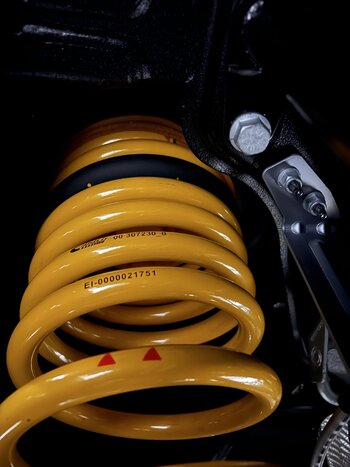

On my US vehicle with factory tow package double red triangle springs were specified which I think are somewhere near the middle of the range of the options available spring rate wise on the rear. Part number is visible in the picture below if that helps.
