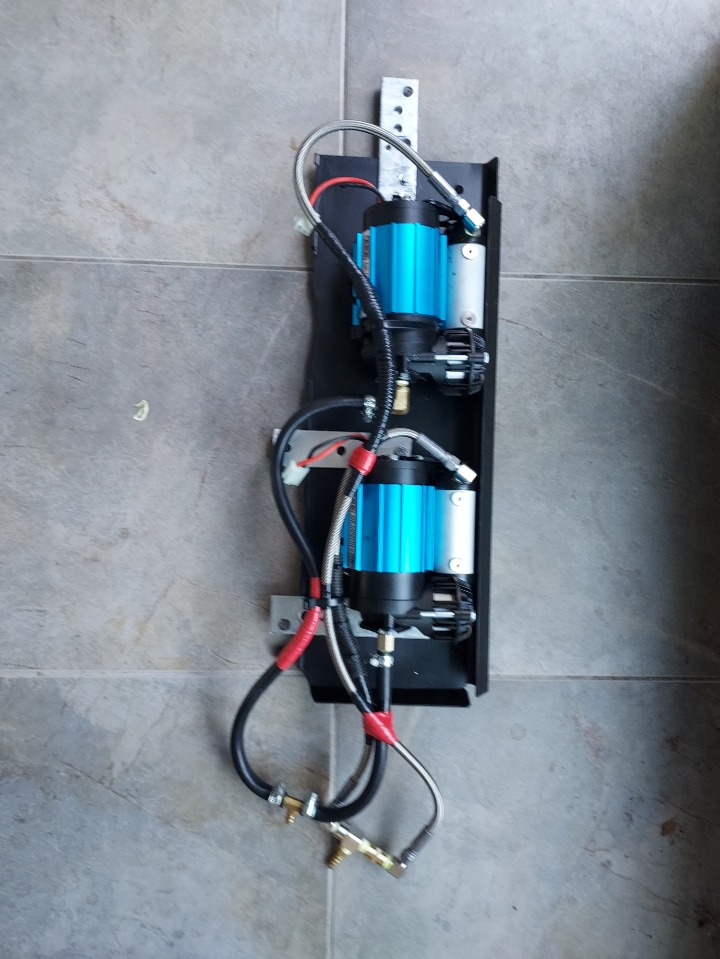

Sorry I was a bit late with the photos, my old 92.2kg 203lb Irish Wolfhound Roland always likes to get in the action, the ARB compressors are mounted above rock slider and chassis height, they are waterproof, and mounted to a bash plate pictured, I made the loom, and the air intake is in the engine bay along with the air outlet, power supply etc.
The tyres are 295/70r17 Yokahama Geolander's on Black Rhino Yellowstone rims 38+, and Eibach aftermarket springs.

Where did you mount these compressors? Could you please provide pictures?
