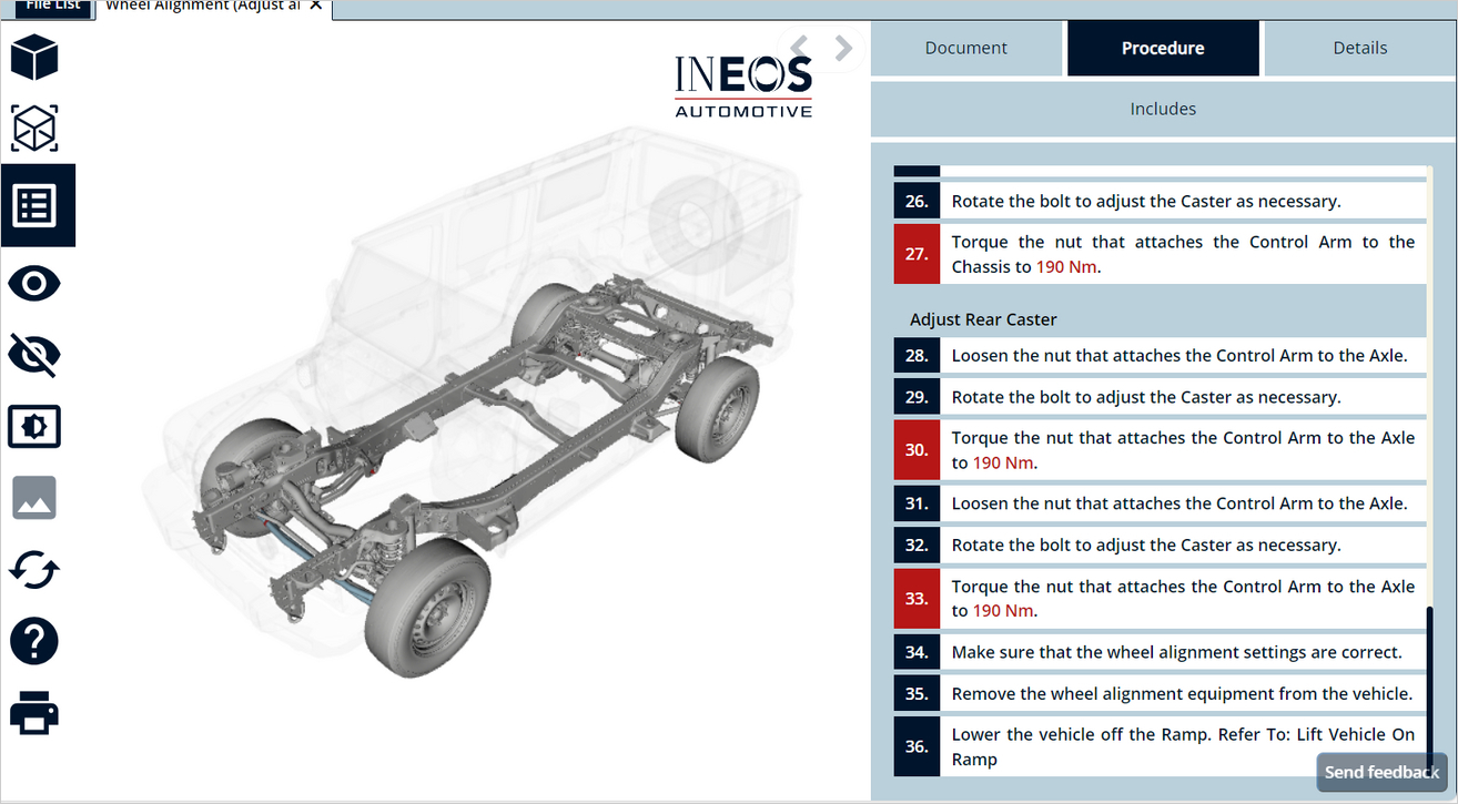

In post #190 above by @NoMoTaco there is reference in one of the Ineos documents to "rear caster"! which I interpreted as what's called "thrust angle" elsewhere relating to solid rear axles.
@CORE Ineos are you able to measure the rear axle alignment of your Grenadier and determine whether this is significant in terms of the reported "wandering" issues?
The dealer shows pretty much 0 or straight on the rears.

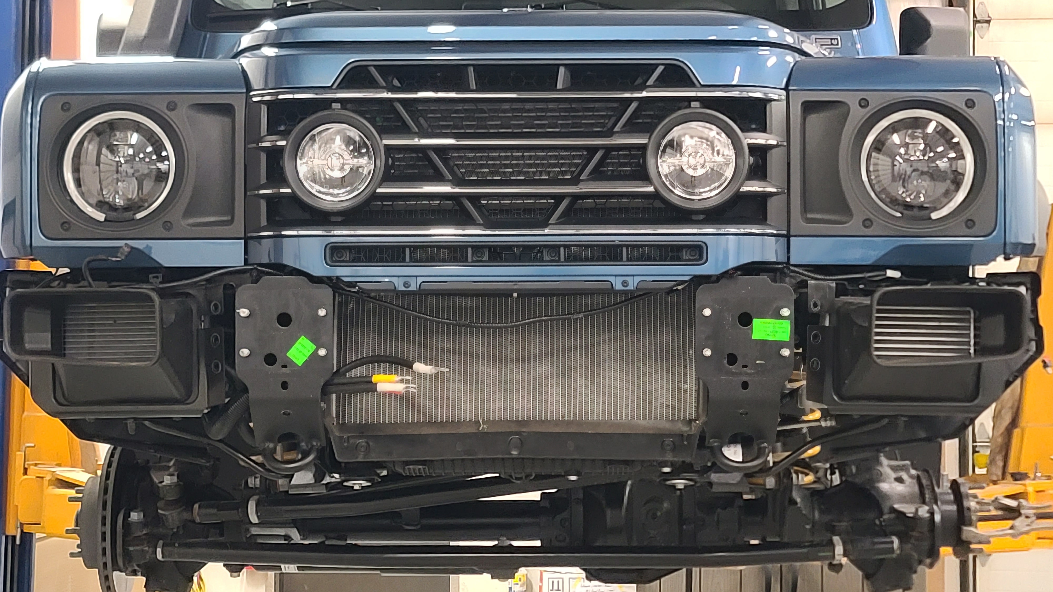

Very impressed that it is a full floating axle they use different flange design then we usually see with Dana or Toyota. A couple of questions, are there any photos of the full axle with the drive flanges and hub attachment? Are the wheel bearings sealed and set with a torque like a lot of newer truck & trailer axles?
Rear bearings are sealed and require a torque of 600Nm according to the engineer at the Tech Talk in Brisbane several weeks ago...

Isn't 0 not quite normal at solid rear? Otherwise the drive shafts and the flange will be tilt (correct term? I mean not in line).
