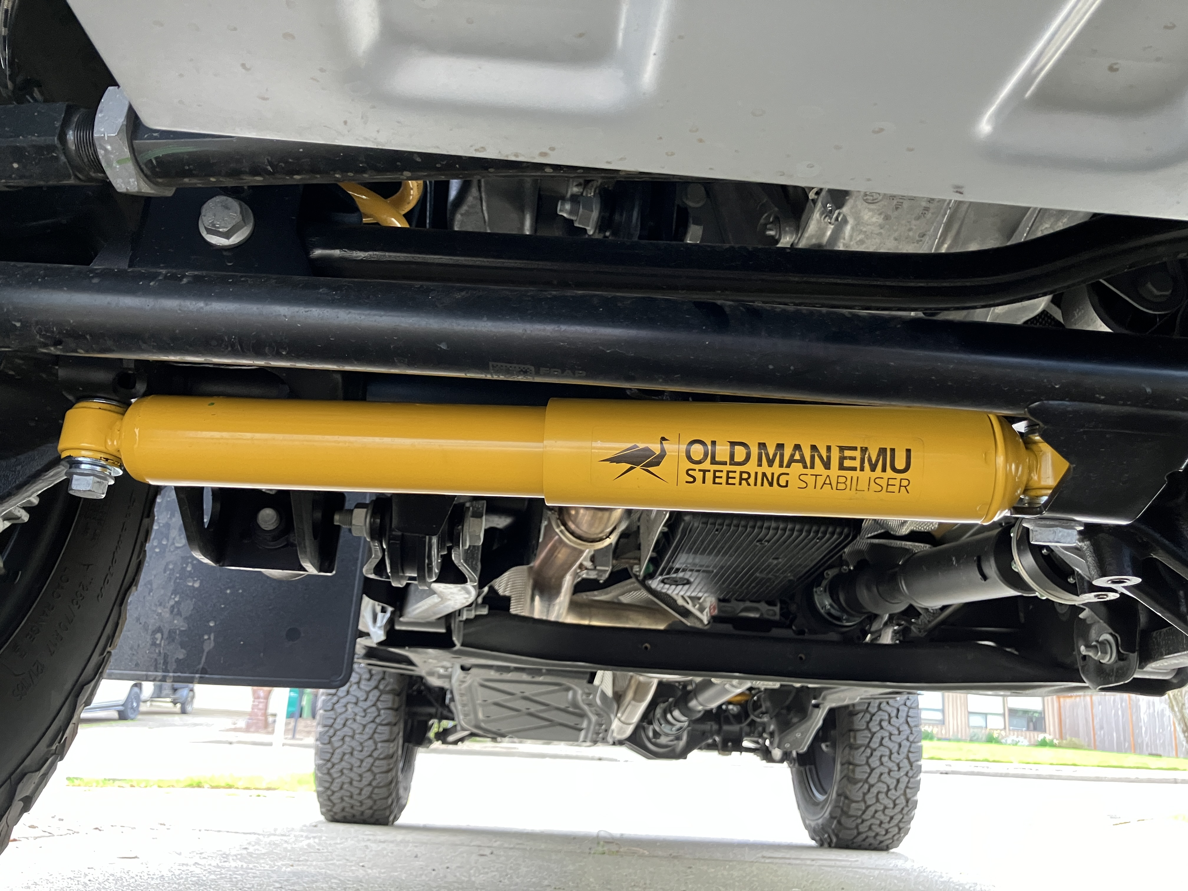

I have a Trialmaster, with 350 miles on it. Yestersday I added an Old Man Emu Steering Stabilizer (Part # OMESD24). I've only driven 50 miles with it on, but there is a noticable improvement in the wonky steering.
Could you be more specific in regards to what constitutes your statement of "wonky" steering? and in what ways you've noticed an improvement?
Wonky in that the IG will "drift or wander" ever so slightly left and right going at highway speeds, and return to center was not happening as I like after making turns. The OME steering stabilizer has improved the wandering and return to center, but only a wee bit. I've just now set the caster to 1º+, and that seems to have taken the wandering out of play.
I've just now set the caster to 1º +, and that has also taken the drifting out of play.
So you've decreased caster over factory? (Factory spec is +2°)
We've reset the Caster back to +2º. We had intended to "Increase" Caster +1º, not decrease. We're back to factory specs now. NOTE: It wasn't possible for us to increase the Caster greater than +2º as hoped for.
