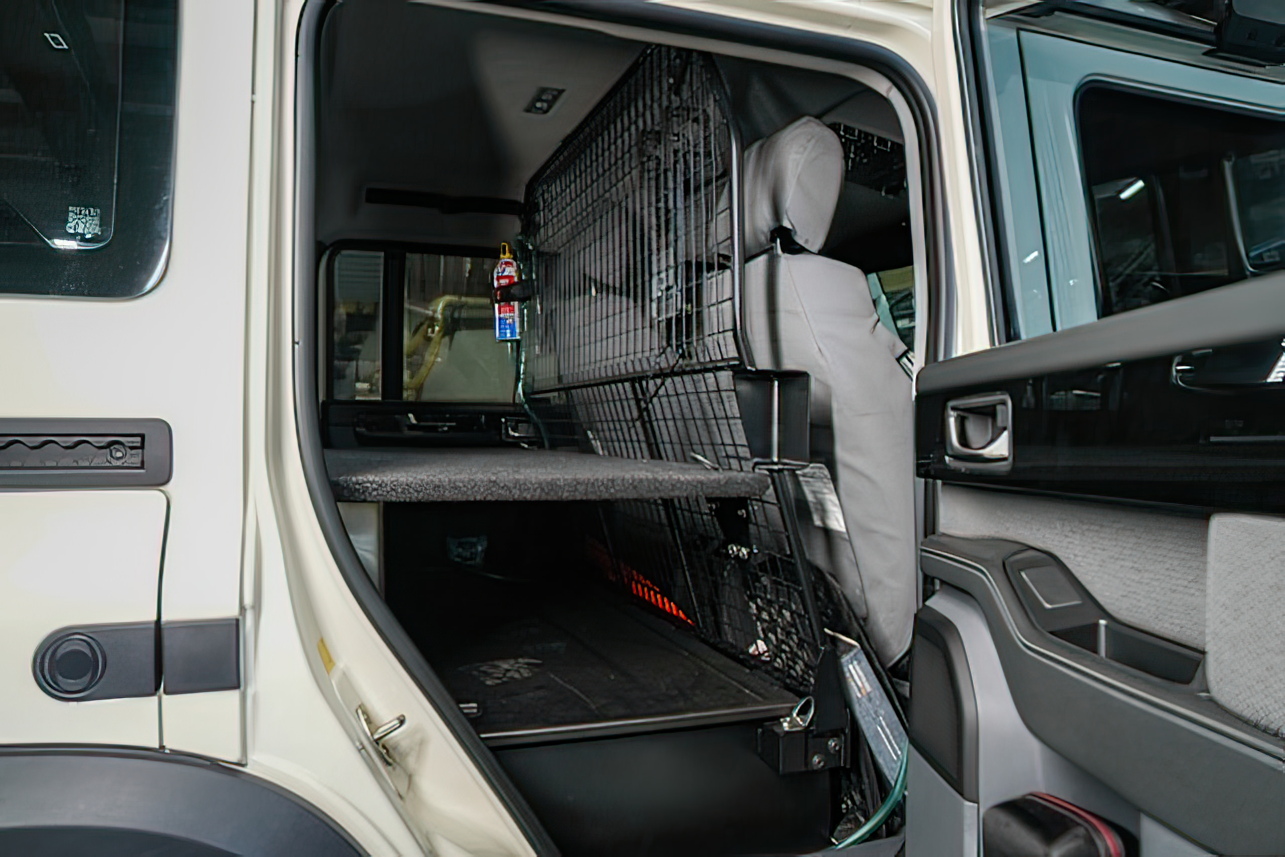

Mine is a fitted water tank as part of a larger build. It is from Offroad Systems who have fitted out several Grenadiers.
Mine is a two seater, but they can do 5 as well.
My fitout is described over at my blog here.
Here is the main post
Mine is fitted water tank as part of a larger build. It is from Offroad Systems who have fiited out several Grenadiers.

Mine was a 40 litre water tank that was generally fitted to a Prado. I had a spill tray built around the water tank, so any water leak did not end up in the battery box. I went installed water tank, @globalgregors went tank in the rear footwell.

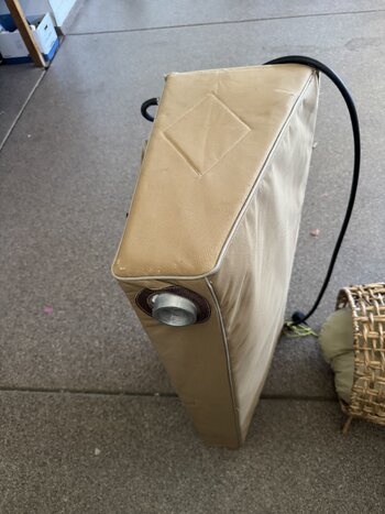

I'm also interested but would like the solution to have a low center of gravity (i.e. not a roof-rack mounted option, but if yours are related to the rock sliders they should have a low CG). In my LC200 I had a removable aluminum tank that was contoured to fit behind the passenger seats and between the two wheel-arches - so it was snug and easy to secure with a pair of rachet straps. It held 80L (which was more than I ever used) and it had a tire-valve (Schrader) so I could give it a few PSI and water would come out of the hose (attached at the very lowest point on the Driver's side) when I had the valve open.
Sadly, it is about 10mm too wide to fit in the Grenadier.
I didn't use it for drinking water, just cleaning water.
Here’s a photo of that tank.
