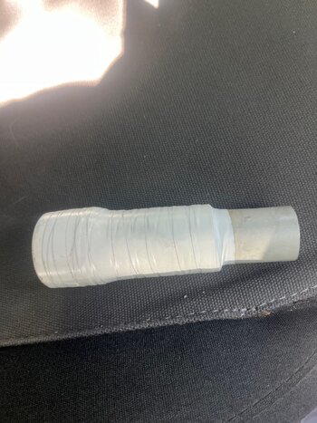

Not really a mod, but a field upgrade. Coming home from Georgetown last weekend, pulled into the servo (petrol station), and the only diesel pump they had operating was high flow. Could not get it in the tank. Had to go to another station.
Looked into what to use as a 32mm id to 25mm od funnel. Came up with 2 pieces of electrical conduit. One 25mm, and the other the flared end of a 32mm piece. Both about 70mm long. I cut 2 slots in the 32mm piece about 20mm long, leaving the flared end untouched. I inserted the 25mm section into the 32mm piece, and heated with a blow torch, and put a band clamp around to clamp it tight. Once cooled, I used pressure PVC glue to glue them together. Presto 32mm inside diameter (the size of a high flow nozzle) to 25mm outside diameter fitting. Easily opens the flap, and can insert the nozzle. I did wrap it in electrical tape, as I cooked it a bit too much, and scorched the conduit.

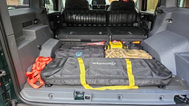

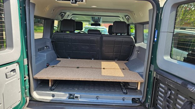

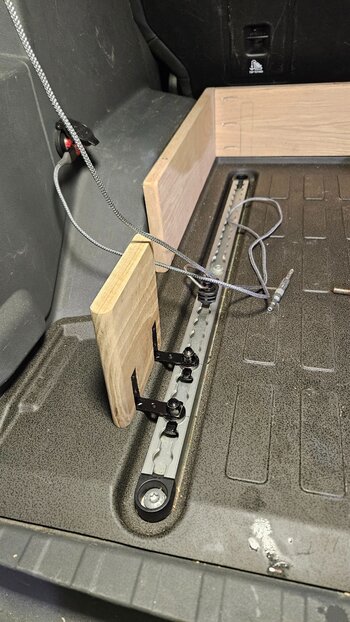

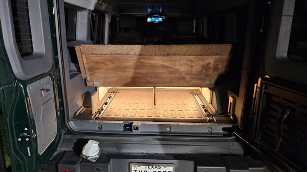

I made a raised deck in the Grenny so I could carry ‘necessary’ gear around all the time without having to keep it covered up with a blanket. My ‘necessary’ gear consists of an air compressor, bag of rachet straps, first aid backpack, tool box, recover bag including kinetic rope, soft shackles, tree saver, snatch ring, and finally two recovery boards. What’s the point in being in a capable vehicle if you don’t have the tools, you need where ever and how ever you might end up? But if I carried this gear all the time anyone could look in the back and see them and I don’t want to be a tempting target. So, I’ve been covering them with a blanket but then anything else I carried in the cargo area was now sitting on non-level gear under a blanket. I also liked how in my wife’s VW Atlas, we have these plastic Velcro corners and stops for cargo management to keep items from rolling around. So, I made a raised deck to cover the gear and the new deck is covered in loop carpet that is Velcro grabbing. The dimensions of the cargo area aren’t so deep that I need a drawer system. I’ve got a long arm and can almost reach the rear seats. I added a hinged front section so I can really reach the back. Added some LEDs on the fixed panel. Front hinge section is wide enough to hold the recovery boards (or a concealed area to hold long guns on range days) with the fixed rear panel having a divided panel down the middle providing more strength. The new deck is flush with the rear seats when the seats are lowered. Use the L-track in the bottom of the cargo floor to secure the deck supports.
