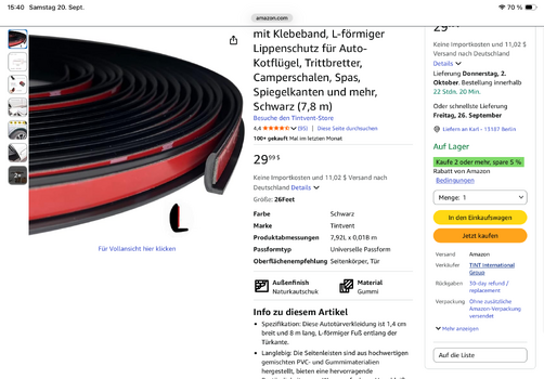

What & where exactly did you buy? I found the originally recommended product on Amazon, bt they would not ship to Germany...
You can buy it at Amazon.com in the USA. They charge you and deliver as if bought at their german shop. Takes about 1-2 weeks.
Search for: tintvent rubber edge trim
