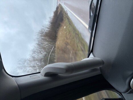

Another crack in the windscreen yesterday - no sign of a stone chip and I don't recollect any stones flying up. Will be my fourth windscreen in two years. Prior to this I think I only replaced one windcreen on any primarily road going vehicle period. On a VW Passat that I stuck my head through the windscreen on 30 years ago.
Interestingly I spoke to my dealer who said get autoglass to sort it rather than us but request a Pilkington windscreen rather than OEM as they are half the price and probably better.

The OEM is a Pilkington so will be exactly the same but I guess maybe cheaper 🤷🏼‍♂️

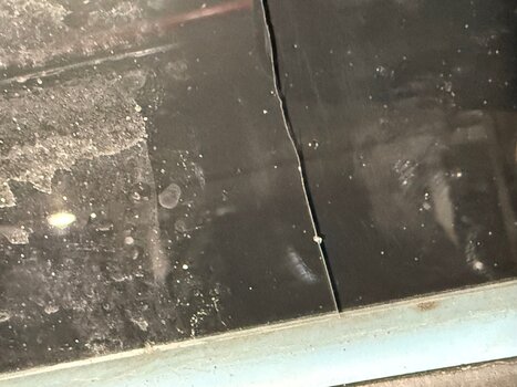

Okay, had a blast in the snow this weekend with the Grenny. I was able to teach my son some important skills as he will take his driver's test soon....but now have a crack in my windshield. At first I thought it was due to my attempt to clear the ice blocks off my wiper blades during the snow storm (had my defrost running the entire time on the windshield but the build up of ice/snow was too much). As you can see from the attached photo there was clearly a stone impact closer to the lower edge of the windshield. With all of that said...I was the third caller to the local dealer this morning (parts and labor $4,200). My insurance will push me towards SafeLite (US Vendor) for $1200. I spoke with the local shop, they have never done work on an Ineos. The detailed quote is for the higher quality glass to permit the camera to do its thing but they are certain they will not be able to calibrate it. I will have to go to my local dealer and have that done, with a reimbursement from my insurance. I have a couple of concerns/questions and welcome any input that might put my mind at ease. I have insurance but they likely won't cover the dealer installed windshield. I am concerned as I read that a seal related to the drainage should be replaced with the windshield, SafeLite knew nothing about this. If it ties into the safari windows (some complaints of leaks have surfaced related to drainage) I'm concerned as mine have been working just fine. I don't want to find myself in a situation where the dealer won't be able to calibrate due to the quality of the glass and then down the road, I run into leaks that no one will own. It's a 2024 model that has been so much fun to drive....I just want to do the right thing. Suggestions? Advice? Thank you in advance!

I have said this before but I really think the heat from the front windshield defrosting is too strong and contributes to this. Small chips at the bottom edge as well because it is exposed. I put a rubber strip at the bottom edge to protect and never turn up the heat over 72.

Floor/windshield is what I’m referring to. If you turn the temp too high, i think it contributes to cracking.

Ineos Disclaimer needed: Please do not use high settings for defrost you may crack your windshield. lawls :)
Ouch.. Can anyone else chime in on what windshield repair is running in your part of the country? I had one replaced but I don't know the cost as it was covered by a windshield insurance from the dealer.
Just had mine done earlier this month - all in it was just under $3100 including tax (I'm in NJ)
Mine cracked on Saturday with the 0° weather and the defrost on high, and a small rock chip.
I have State Farm $0 deductible here in Colorado and Safelite will do the replacement. Safelite buys the glass from Ineos, there is no after market glass yet.
Then I will need to have Red Noland calibrate it ($375). And submit that to the insurance.
Question - why does it need calibration? The glass should be the same thickness at the same angle to the camera, there should be no change. We don't calibrate our cameras when we change the lens, this is the same thing. I guess I will learn next week.....
Southern California, INEOS of Irvine
Windshield replacement with ADAS recalibration was $3345 all-in. Reluctantly covered by AAA minus the deductible because no generic glass is available and no one other than INEOS dealers can recalibrate ADAS. I got my new windshield and immediately put the XPEL windshield protection film on at Advance Auto Engineering in Fullerton. I highly recommend Advance Auto Engineering for tints/films/wraps.
