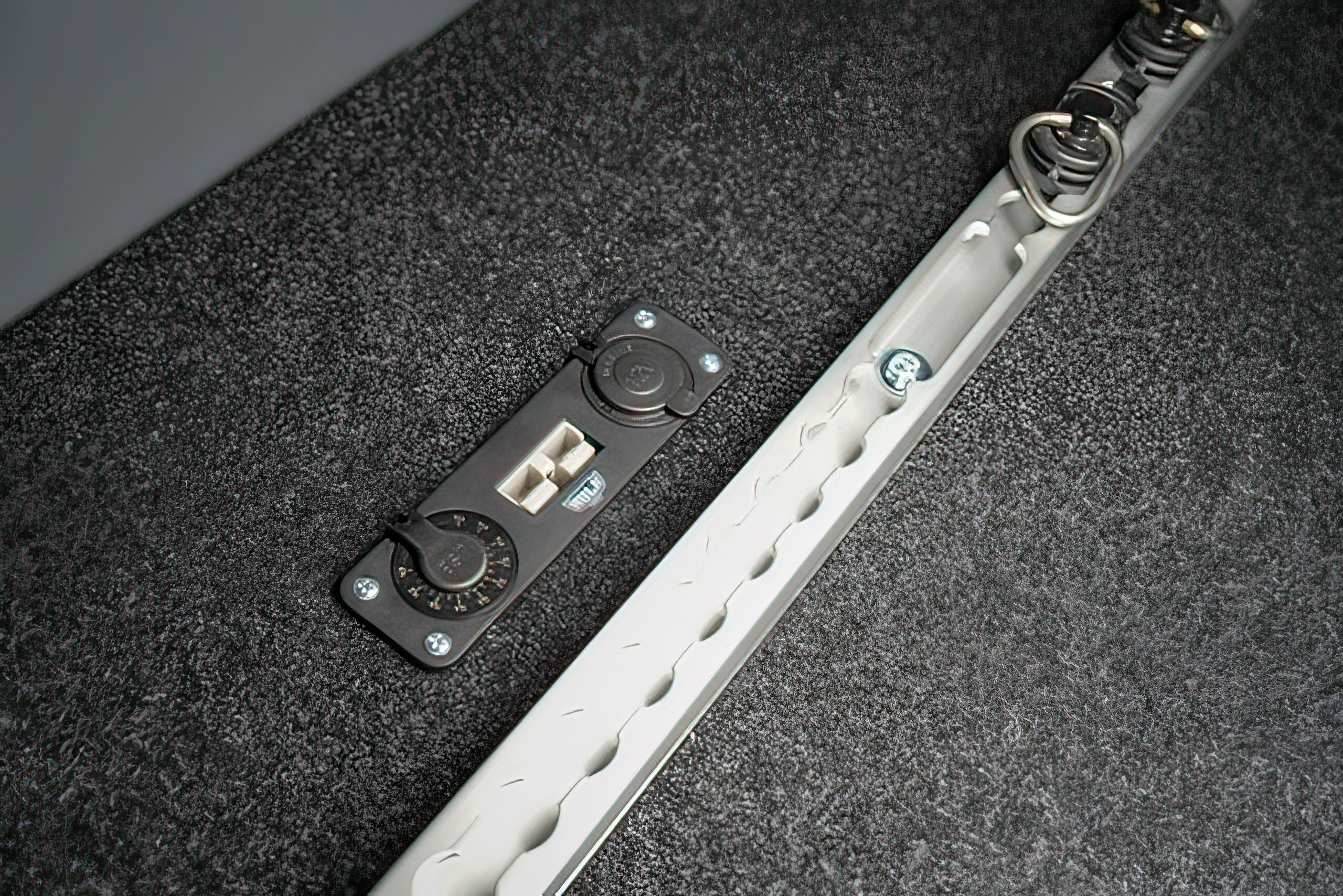

L Track can be purchased here. Cut it to size (if needed). AU source, competitive pricing.
Multiple links here for sources around the world.
Most of the third party suppliers quick releases tie downs work on the Grenadier. INEOS used standard L track size.
