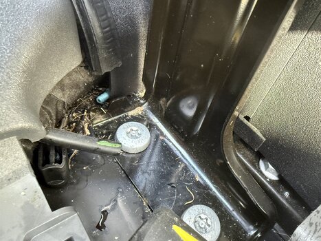

There's a join in the pipe under the RH rear seat. The barb joint comes apart and fluid floods the RH rear footwell and undersea area.
RH as viewed from the rear of the vehicle facing forward.
I checked this, thank you. Nothing under the seat - thank good ness..
However, I did a prolonged "wash" on the stalk today. The barb in the engine bay popped off (it was secured previously) so there is a pressure build up indicating that there is either a blockage or issue downstream. I just don't know the routing to trace. Suggesting this is a dealer issue that should be figured out.

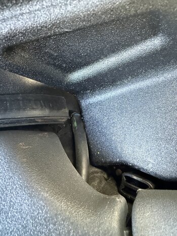

Mine has no water at rear screen wash. Checked and yes connector at mid vehicle next to rear seat at rear door RHS had disconnected. BUT upon reconnecting and trying the wash it popped off - indicates further problem downstream - either a kinked pipe or a blocked nozzle. Will leave it to dealers to explore next time I’m there.
PS side plastic cover on seat was a PITA to remove - middle “screw” isn’t a screw. Seems to be sort of single use clip that breaks rather than disconnects. Or am I just not getting how it works?

One of the first repairs my agent did was fix an inoperative rear washer. The repair was to bypass a section of hose somewhere between the right rear corner, flexible duct, and inside the big door.
The hose is inside the wiring harness that goes to the door. The harness is tightly wrapped and that was crushing the washer hose. The fix was to cut the hose either side of the harness entry and exit points then run a new section of hose outside the harness. That was seen as preferable to unsealing the harness to release the crushed hose.
