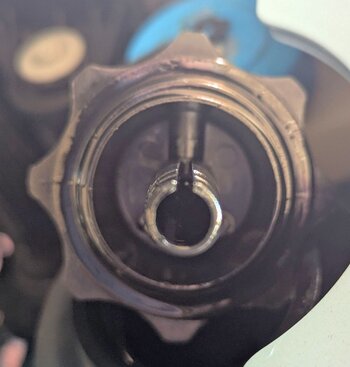

I just picked my Grenadier up from the dealer (service overdue is cleared, pleasant surprise). My main concern to be checked out is fluid appears to be escaping the p.s. reservoir. They said this was common on Grenadiers and not to worry about it. I guess I have to put up with oily residue all over the engine bay.(?)
It's a vented cap. If the fluid is hot or the fluid level is high it's going to vent some mist. Agile sell a thicker cap o-ring supposedly to improve the sealing. Except it's a vented cap so 🤷‍♂️
I was going to look for a better o-ring or something. The engine compartment was dusty with road dirt since I bought it. Now it's oily, wipe your finger on the shine and get residue.
Exactly. A fancy O ring won't help.
Are you certain it's power steering fluid residue? What colour does it taste like?
If you're keen to isolate it, rag everything clean around it then tape a clear ziploc bag over the reservoir. No so tight that the reservoir cannot breathe but secure enough to keep the bag in place. If the inside of the bag gets filmy after a few days and everything around it outside stays clean you have your culprit.
I'm not sold on a phatter cap o-ring though. It's not a pressurized reservoir. Even if the o-ring was undersized there's no internal pressure to force mist past the cap.
