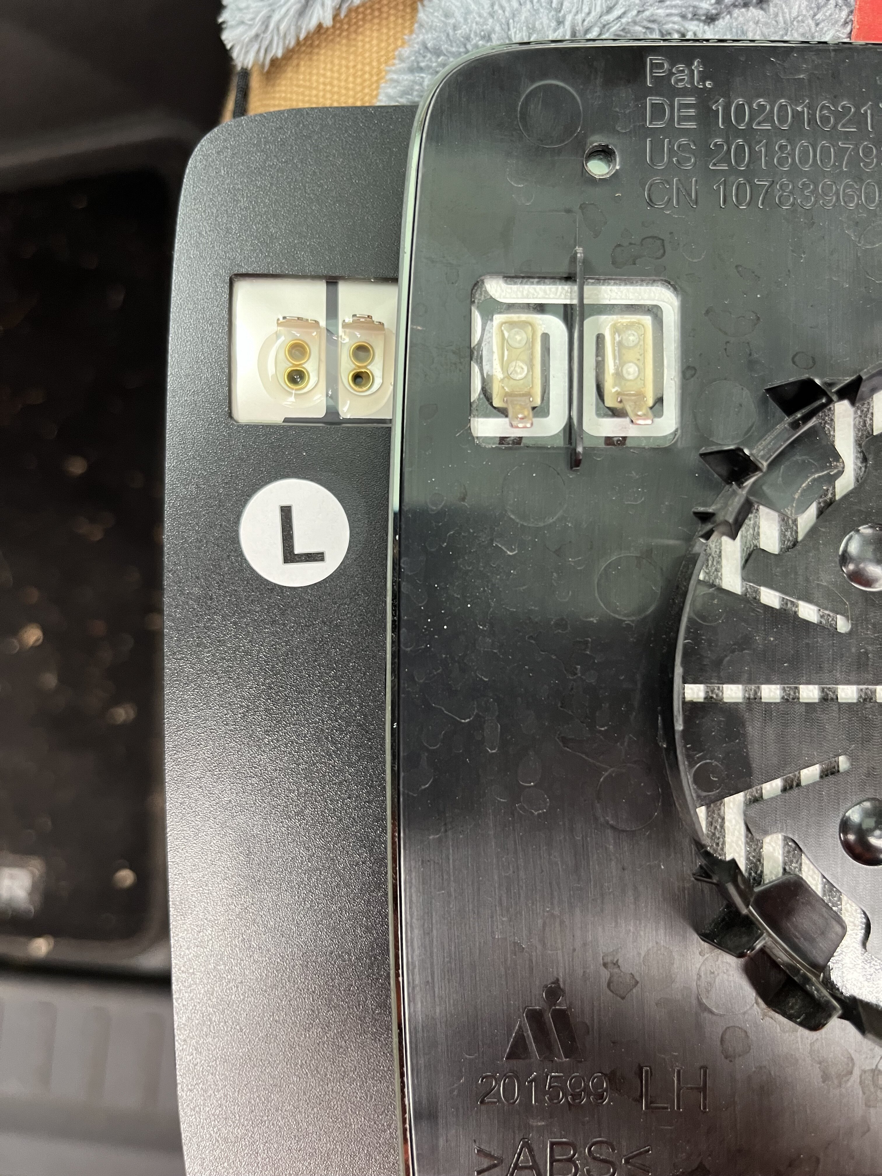

I wonder if the sticker on the Suma mirrors is on the wrong mirror (i.e left on right and right on left)? I see that several people have had the same issue as you, but on my Sumas the posts were in the same location as the stock mirrors so there was no need for an extension.
Hi Leeroy
For me, the difference is the electrical spade on the original mirror protrudes from the top of the
Hi Leeroy
If you look at the annotated pic attached, you can see how the spade connection differ. This 1/2” difference, makes it impossible, in my case at least, to fit the mirrors with heating wires attached.
DaBull mentioned that his Suma mirrors came with pigtails attached. Mine, unfortunately didn’t have any such component.

The mirrors are suppose to come with pigtails... I installed the passenger mirror not knowing it should have come with pigtails, my wires were short and I had to take the suma mirror off after installing because it seemed like it was restricted movement from the incorrect terminal orientation. Taking it off was 1000x harder than stock and it broke two teeth and SUMA is refusing to give me a new mirror, "the broken taps doesn't impact installation". They are sending me the pigtails. This company is not customer focused, not impressed. I'd honestly rather just have my money back, than been waiting 3 weeks for a response to my email and then refusing to replace a mirror that broke because they made the mirror wrong and didn't include the pigtails.
