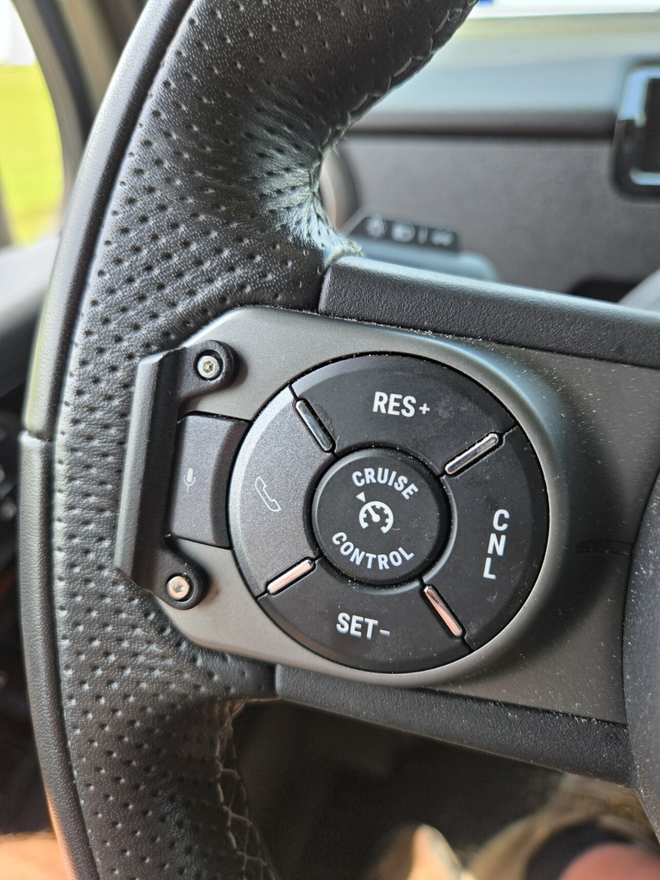

I used some rattle can black on mine and they look great. I no longer invoke the oracle of Google every time I one hand the wheel backing out. Two thumbs up.

I did the same thing. Satin black worked well for me. Also rattle-canned the keyhole light and very happy with it.
Nice work on the paint! I love that I made a modification to the original Ineos design, and now people are modding my mod! Please keep us posted on how the paint holds up over time.
