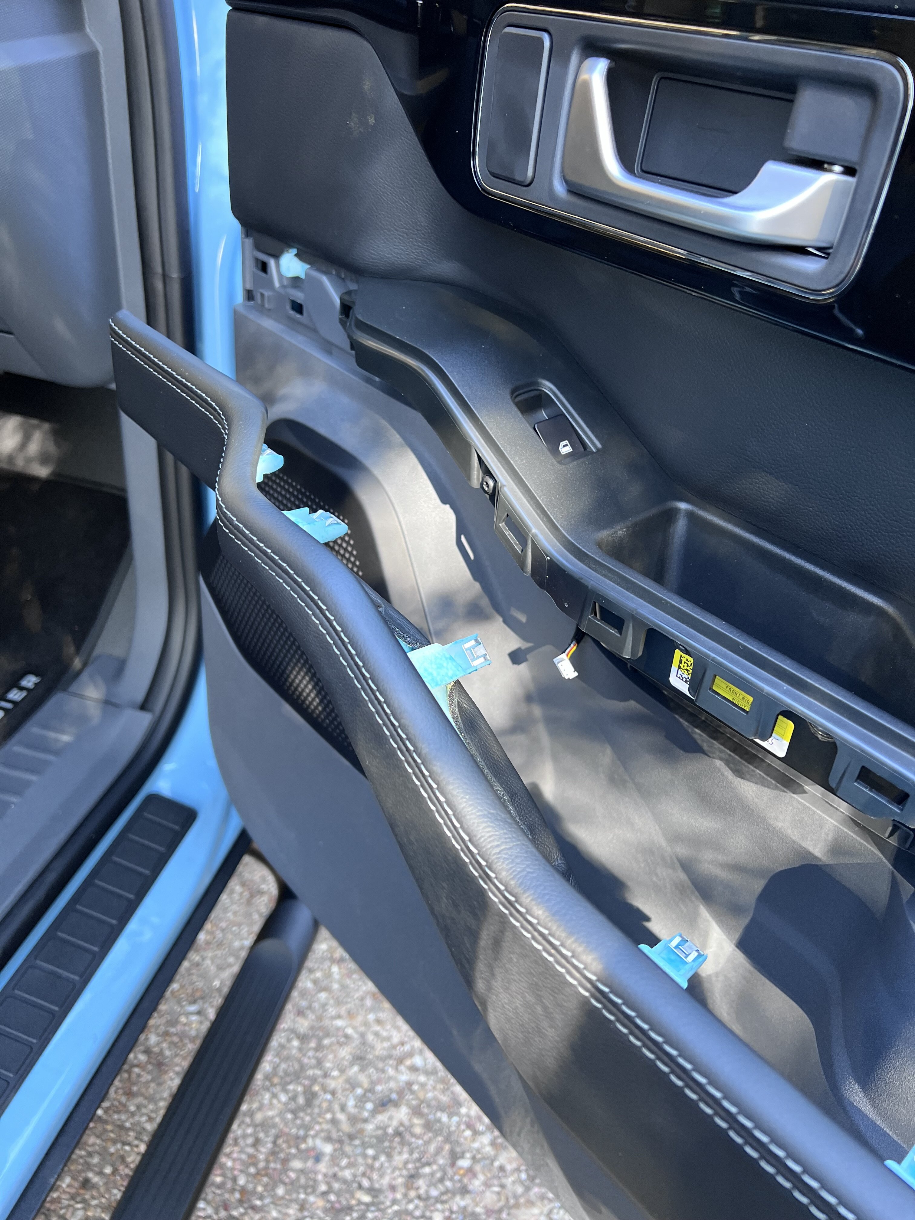

From what you describe it sounds like it is the connection has come loose. Gently lift out the wider flat surround in the handle top were the switch is located, not the actual switch itself.

For those that are having issues with power lifter. It is super easy to check the connections to window lifters. Photos attached (I used a plastic shim to start the removal of the section of the panel but you can just pull it out. the connector somehow came undone. plug it back in and the window controls work again. easy peasy.
