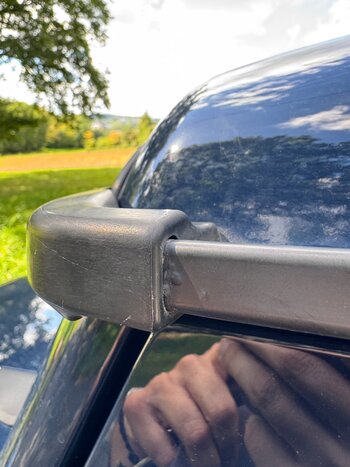

I don't know how my transfer case looks like, but I just saw something that looks like rust to me yesterday. Has anybody seen something similar on the drip molding?

Next to the weld? Pick at it and see what colour the powder is.
