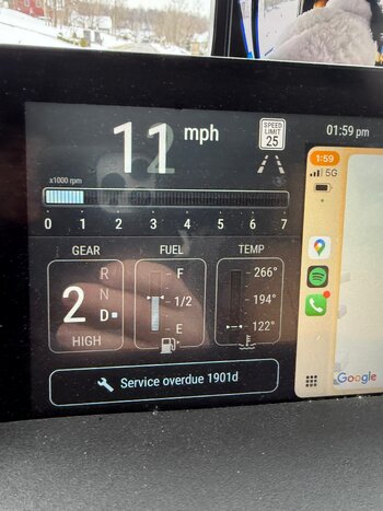

Steve B and Jean Mercier no alert.
INEOS has acknowledged the issue here.
C-Mack still in the lead with the Chook as tail end Charlie. Wile E Coyote is doing much better than when he takes on the Roadrunner.
55 members listed so far, from lowest to highest number of days. If I missed you tell me.
Error Msg / Modulo 1024 / 10-bit Binary / Days Since Service Due / Service Due Date

. . . so if INEOS only used a 10-bit two's complement for signed binaries, they would truncate values with modulus 1024 (keep subtracting 1024 until you get a number smaller than 1024). In other words, they don't expect someone to go more than 1024 days (2 years 9-1/2 months) without getting a reset. Using that scheme, I generated a table showing the error message days in the first column and your expected service date in the far right column. Does this jive with reality for anyone?
Code:Error Msg Modulo 1024 10-bit Binary Days Since Service Due Service Due Date 1840 816 1100110000 -208 Jul 28, 2026 1841 817 1100110001 -207 Jul 27, 2026 1852 828 1100111100 -196 Jul 16, 2026 1852 828 1100111100 -196 Jul 16, 2026 1868 844 1101001100 -180 Jun 30, 2026 1869 845 1101001101 -179 Jun 29, 2026 1890 866 1101100010 -158 Jun 08, 2026 1892 868 1101100100 -156 Jun 06, 2026 1894 870 1101100110 -154 Jun 04, 2026 1899 875 1101101011 -149 May 30, 2026 1906 882 1101110010 -142 May 23, 2026 1915 891 1101111011 -133 May 14, 2026 1927 903 1110000111 -121 May 02, 2026 1931 907 1110001011 -117 Apr 28, 2026 1932 908 1110001100 -116 Apr 27, 2026 1933 909 1110001101 -115 Apr 26, 2026 1937 913 1110010001 -111 Apr 22, 2026 1940 916 1110010100 -108 Apr 19, 2026 1945 921 1110011001 -103 Apr 14, 2026 1950 926 1110011110 -98 Apr 09, 2026 1953 929 1110100001 -95 Apr 06, 2026 1967 943 1110101111 -81 Mar 23, 2026 1968 944 1110110000 -80 Mar 22, 2026 1968 944 1110110000 -80 Mar 22, 2026 1975 951 1110110111 -73 Mar 15, 2026 1989 965 1111000101 -59 Mar 01, 2026 1903 879 1101101111 -145 May 26, 2026 1994 970 1111001010 -54 Feb 24, 2026 1995 971 1111001011 -53 Feb 23, 2026 2007 983 1111010111 -41 Feb 11, 2026 2007 983 1111010111 -41 Feb 11, 2026 2007 983 1111010111 -41 Feb 11, 2026 2009 985 1111011001 -39 Feb 09, 2026 2022 998 1111100110 -26 Jan 27, 2026 2024 1000 1111101000 -24 Jan 25, 2026 2025 1001 1111101001 -23 Jan 24, 2026 2044 1020 1111111100 -4 Jan 05, 2026 2048 0 0000000000 0 Jan 01, 2026 2057 9 0000001001 9 Dec 23, 2025 2057 9 0000001001 9 Dec 23, 2025 2059 11 0000001011 11 Dec 21, 2025 2074 26 0000011010 26 Dec 06, 2025 2095 47 0000101111 47 Nov 15, 2025 2097 49 0000110001 49 Nov 13, 2025 2097 49 0000110001 49 Nov 13, 2025 2106 58 0000111010 58 Nov 04, 2025 2107 59 0000111011 59 Nov 03, 2025 2137 89 0001011001 89 Oct 04, 2025 2150 102 0001100110 102 Sep 21, 2025 2156 108 0001101100 108 Sep 15, 2025 2190 142 0010001110 142 Aug 12, 2025 2253 205 0011001101 205 Jun 10, 2025 2367 319 0100111111 319 Feb 16, 2025 2458 410 0110011010 410 Nov 17, 2024
Notice that users who got an error message of >=2048 would have already received a legitimate service due message on or before Jan 1, 2026.
Unfortunately that doesn’t give the correct service due date for my error 1869. I’m due next in late November this yearMore wild speculation . . .

There is something called the "2038 Problem" where millions of 32 bit processors will run out of code in January 2038. I suspect it may be something like that rather than Y2K.Is this the millennium bug finally showing up - just a quarter of a century late?

When I was a lad in the 70s, the year 2038 seemed like a time when cars had been long superceded!There is something called the "2038 Problem" where millions of 32 bit processors will run out of code in January 2038. I suspect it may be something like that rather than Y2K.
