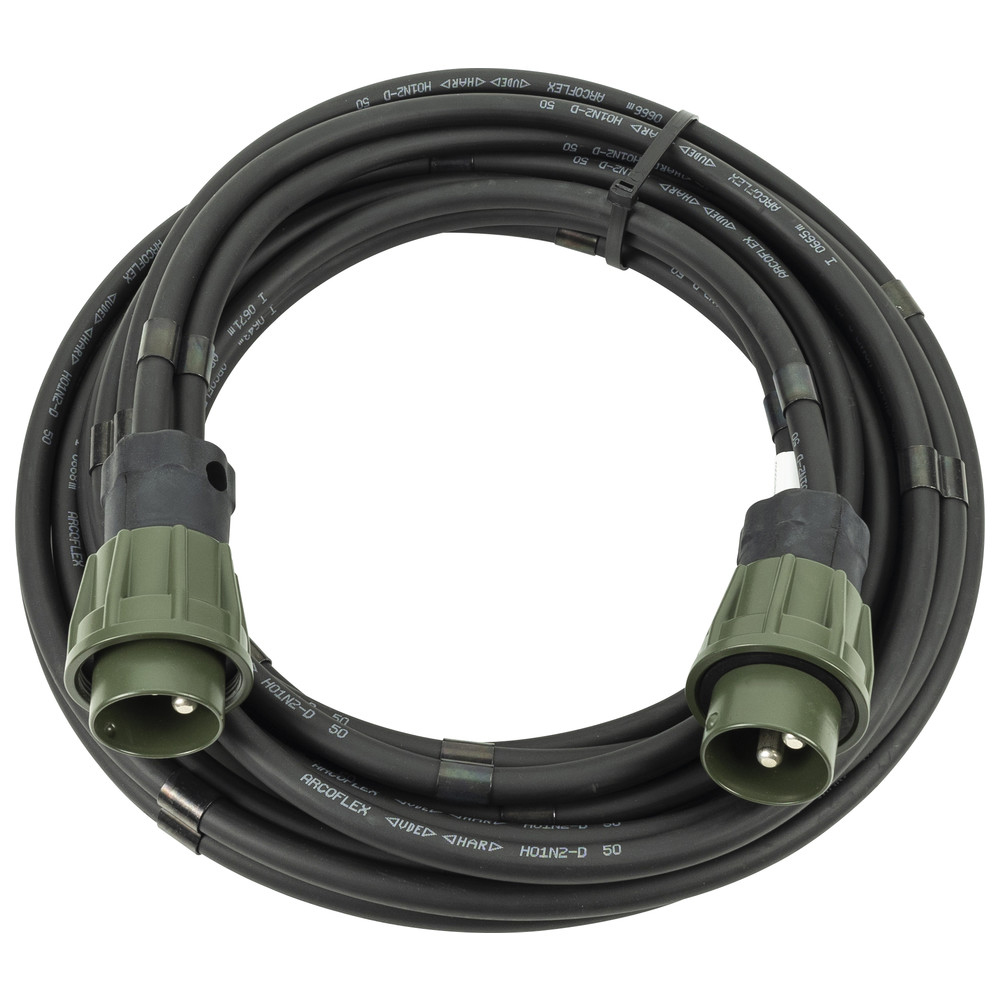

So does the NATO socket in the Grenadier has the same function? Supply power to an other vehicle (or implement like a winch) AND receive power to be jump started. Sorry if the question was already answered. Have not found anything on this special topic neither in the forum nor in the manual.
This is how this kind of jump start cable looks:

Having jump started hundreds of cars I would like to point out some things:
  • Major problem is completely dead battery. Nothing is usually enough to overcome this.
  • Second problem are the clamps that are in all commercial jump start cables. As the current draw os starter motor is hundreds of A these clamps are not able to transfer anything even close to that. See below.
  • Next problem is voltage drop in cables. Small section area and long cable causes great voltage drop which prevents effective help. Typically at least the sectional area is too small in many cables. I like to use 50 mm2.
  • Cold weather adds challenge by lowering efficiency of battery and causing extra resistance to rotating parts. Pressing clutch helps in case of manual transmission as the gearbox doesn't need to rotate.
I have made fixed installation of these connectors to most of my cars with short 50 mm2 cables. The red one is classified to 350 A which is enough for starting purposes. A smaller grey (50 A) is used for freezer, compressor etc. Similar connectors on the receiving end of loose cables.
listaus_TRUKKILIITIN-SB175-KAKSINAPAINEN-PIN2-JOHTOON-600V_6329G6_2a37ae4916765c97d6fe9af2f2d8587d_1.jpg
What rating the NATO connector has? Anyhow there may be a problem with overall cable length. Total length: battery 1 -> car cables 1 -> loose cable -> car cables 2 - starter motor 2 will be over 10 metres x 2.
