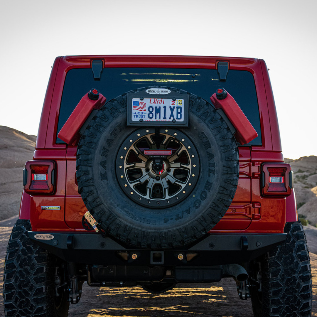

If you are only going to be carrying extra fuel a couple of times per year, then carrying the fuel on some sort of rack on the rear bumper doesn't seem overly risky. Its not like you will carry that fuel 365 days per year. Secondly, the majority of fuel carriers I've seen position the jerry-cans well above the bumper, keeping them well-clear of explosion risk from a basic "fender-bender" (see - for example - the photo of Rotopax fuel-containers mounted on the Jeep below). You would have to be the victim of a high-speed rear-end collision for there to be any risk of explosion. That is extremely unlikely in the outback, so it is only a possibility during your trip out of town, as you travel to a track like the Canning Stock Route (which you might do once per year?). Coming back into town, one would assume your jerry-cans will be empty. It seems that the likelihood of suffering a high-speed rear-end collision during the few hours per year you may be carrying the extra fuel on a highway is fairly low. That's just how I see it, but we all assess risk differently, and have to be comfortable with our own choices.

[QUOTE username=stickshifter userid=8617054 postid=1333006679]Hi Che,
[/QUOTE]
Totally agree, in the CSR scenario it’s not really a problem. Sadly on any highway or urban driving the risk is out of your hands by and large when you have people towing overweight caravans, tailgating, playing with their phones and all sorts of stupid shit. For me that risk isn’t worth it and I’m pretty sure it’s illegal where I live.
As you say we all have our own risk tolerance, you can make your own assessment based upon your own circumstances.
