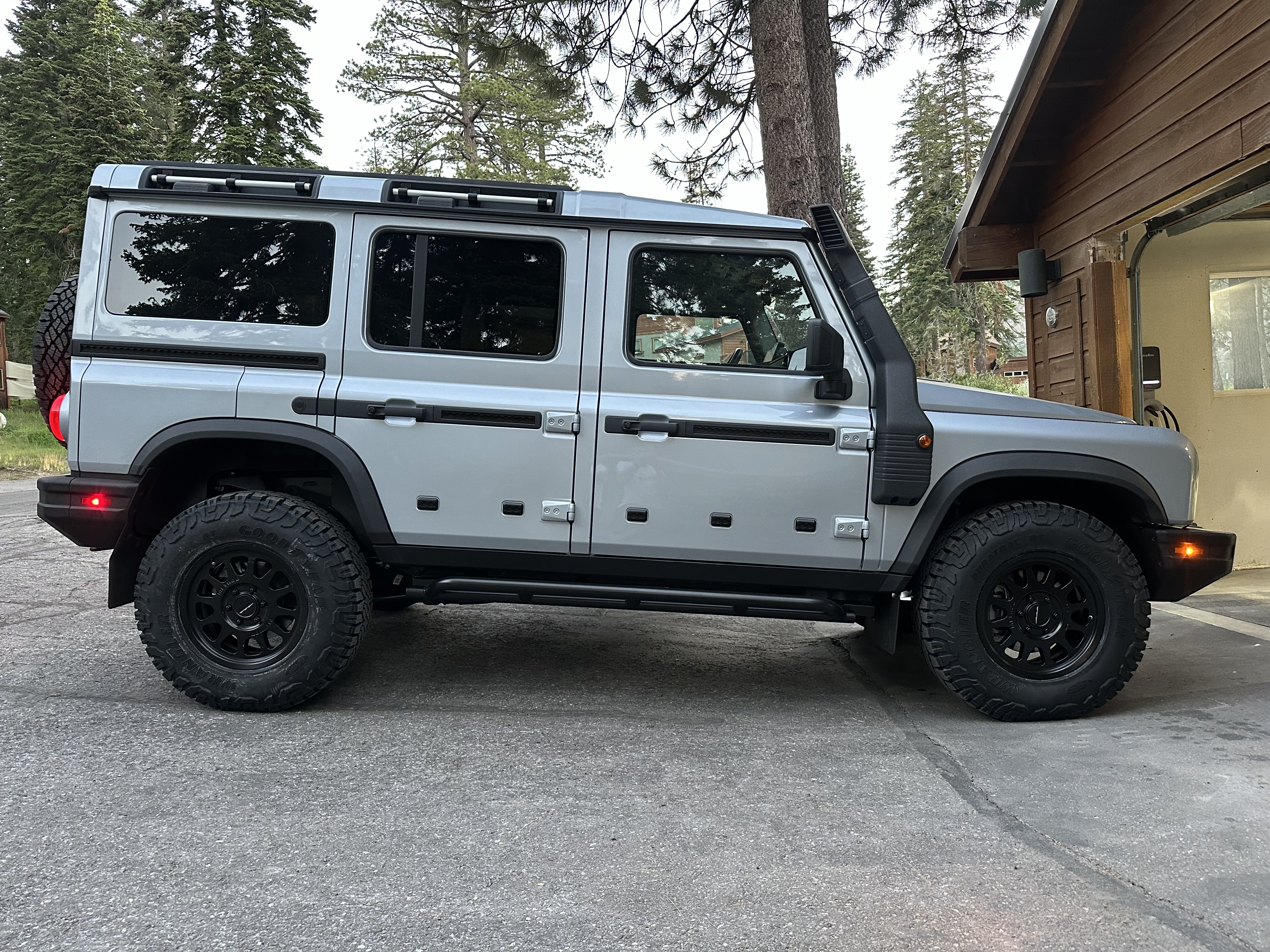

I got pizza cutters:
I went with the Duratrac RT in 255/80R17 on Method 703 wheels. The slightly smaller offset on the Methods maintained the same scrub radius for the taller 33” tires so I don’t feel any difference in steering compared to stock. The Methods and the Duratrac RT ended up weighing exactly the same as the stock alloys and KO2s at 81.2 lbs each. So other than the slight loss in gearing, I don’t feel much difference in acceleration or power going uphill. I’ve raised the garage opening to 7’ so the Grenadier will now fit the garage with the Leitner rack installed.
You may be wondering why I bothered getting the alloy wheels and KO2s. I originally ordered them and then changed my mind but I wasn’t able to change my order anymore. Should have got the steel wheels. I will be using the stock alloys with winter tires, probably the Hakkapeliitta LT3.

Hi TahoeGren, I like your thought process on rims and tire size and keeping the same scrub radius. What are your thoughts in regard to on road sound noise level vs the KO2's. DaBullI got pizza cutters:
Noise level is about the same, maybe a little bit quieter but sounds different. I would characterize it as a different pitch. The original Duratracs get loud when they wear down. I’m hoping the RT stays a bit more quiet since they have compromised a bit with narrower voids now, making them more like a regular AT tire.Hi TahoeGren, I like your thought process on rims and tire size and keeping the same scrub radius. What are your thoughts in regard to on road sound noise level vs the KO2's. DaBull
