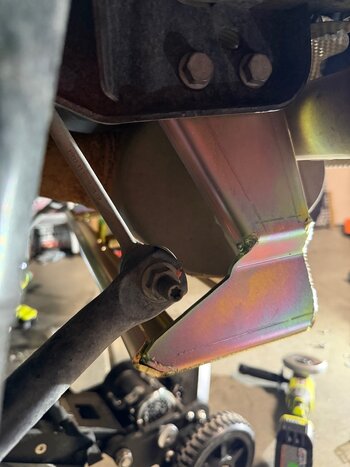

While down there I added the @Metalcloak bumpstops and rear muffler brace, which obviously would’ve helped with my mangled rear skid courtesy of Panamint run with John from Agile Offroad. Replaced the mangled Rival with a new one, painted in my obsession with safety orange. Yes, I know there are other options available, but it did its job already, and they were helpful in a replacement purchase.

Now, thanks to your photos and info, I too have a Metalcloak reinforcement under the muffler skid plate.
