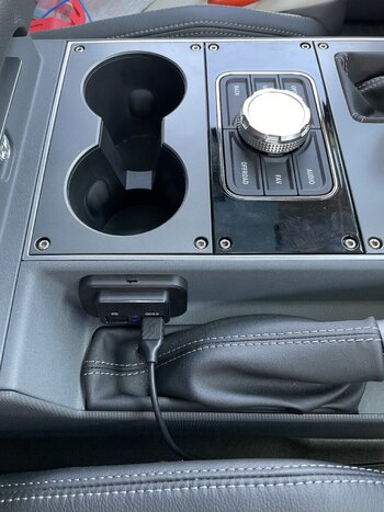

I just installed mine using a Lightforce panel (RHD car), powered from the driver's side footwell wire ends. It is the Lightforce CBSW4TY2 fascia. The USB charging port for the panel is the CBUSBR (Ford Ranger version). I got this information from the Lightforce help desk. Lightforce does have a presence in Europe and the US.

Mine are very similar units, just a bit more rounded. Have not had any issues with knees, as they don't protrude much at all. I had them professionally installed since there is a 100% chance of me screwing up the electrical system.
