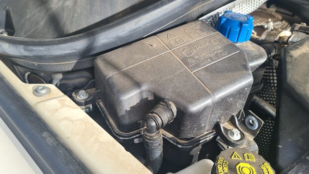

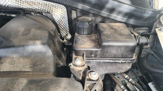

Mines been leaking for a while, I didn’t post anything about it because I’m tired of people attacking every problem I have. But yeah mines leaking at the seam and always had to be topped up. You could also smell coolant in the cabin.
I picked up my vehicle in Dec 2023 from 4x4Garrage in Canberra, and BOTH tanks had white leak marks from the showroom floor! The heater also didn't work. For one year I was told that it was normal, and the heater works as it should. I have winter temps of -10C, and I can drive hundreds of km's and the heater would never blow warm air... I eventually began topping up the blue/hot res every few months with approx 2L of coolant (the res has been completely empty several times). I have 60,000km service soon and will ask for both tanks to be replaced.
