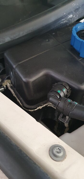

I picked up my vehicle in Dec 2023 from 4x4Garrage in Canberra, and BOTH tanks had white leak marks from the showroom floor! The heater also didn't work. For one year I was told that it was normal, and the heater works as it should. I have winter temps of -10C, and I can drive hundreds of km's and the heater would never blow warm air... I eventually began topping up the blue/hot res every few months with approx 2L of coolant (the res has been completely empty several times). I have 60,000km service soon and will ask for both tanks to be replaced.
I photographed mine and a loan/courtesy vehicle to prove my point

I have the same problem, dealer told me to wait 3-4 weeks for the part to arrive and i have a long trip (5000 KM) that i don’t want to miss out on. Can i just refill the coolant whenever it’s low? Or try and cover the leak by some kind of way?
Hey Guys,
Maybe some JBWeld or other plastic weld to do a fix. It Is the sort of thing you want to be carrying with you anyway for a field fix of a plastic part.

Mine has been like it for thousands of miles, I have just topped them up. Initially I had to prove they were both leaking and then I had to wait for parts, then one of them was incorrect and I still have 1 dodgy one fitted. I have only topped up not tried to seal so in theory you should be ok
Decided to weld the plastic around reservoir and seal it with some kind of silicon or glue. so far it looks fine. hopefully i don't face any issues during my trip.

The coolant tank will be close to a 100% failure rate. In Moab nearly all had white scum from leaking as they went through tech, some were really failing. All will need replaced. Also be sure to ask for an updated O ring for your Power Steering resevoir cap when at a dealer, those are all leaking as well.
Same problem: high pressure circuit reservoir seam leak after a 2500km trip... was advised yesterday it's 4 week's wait for repair:mad:
What evidence can you see @DenisM? Is it losing pressure also?
I wiped off what I believe was white cyano adhesive powder residue from both my reservoirs maybe six months ago and it hasn't returned. I've seen similar pics posted with that same white residue so assumed it's a leftover from manufacturing.
Weekly checks of coolant level... required 750ml after returning home. The "residue" wasn't visible previously....😉 20251023_103744.jpg
