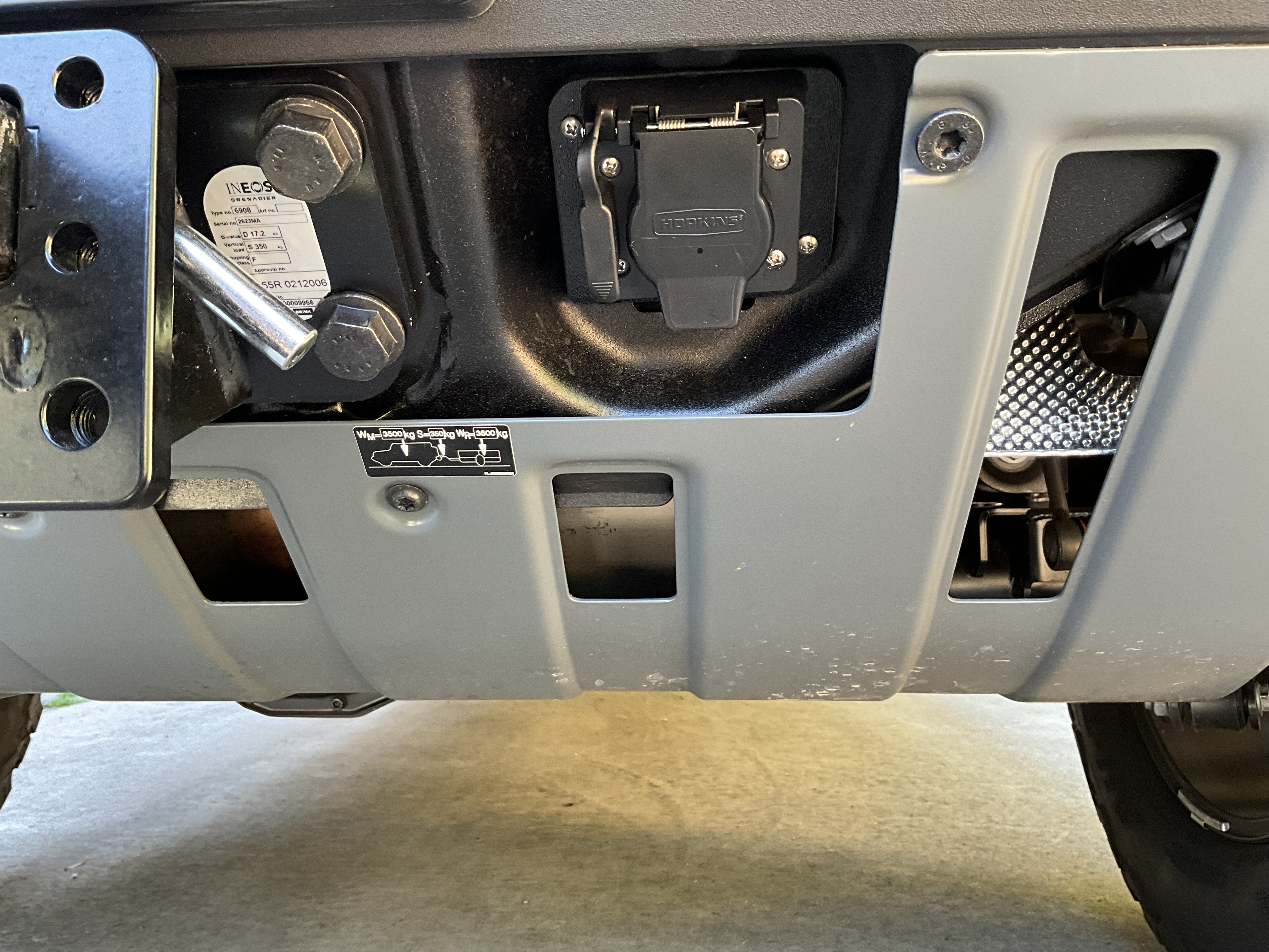

I took this photo today on the rear bumper of one of the sold units at RDS today. Of the 12 units on the ground, non have tow hitches. RDS should start to receive tow hitch orders the week of the 18th.

I didn't realize it had an integrated trailer brake
You wouldn’t want to tow a trailer without correct 'breaking' functions. 🙂

@junx i don’t believe it has a “integrated trailer brakes” or “brake controller”, just wiring.
It doesn't have a built in brake controller, but one of the pins of the standard 7 pin trailer plug is for trailer brakes
